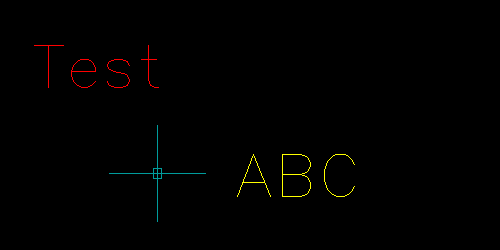

  6. For the property & formatting code shown in your image, you would need to use: (defun c:test ( ) (LM:QuickField "TextString" "%tc1" 1)) However, since the program doesn't allow you to select nested objects (such as attributes) by default, you will also need to change line 248 from: (list 'if '(setq ent (LM:SelectIfHasProp prop entsel)) to: (list 'if '(setq ent (LM:SelectIfHasProp prop [color=red]n[/color]entsel))
