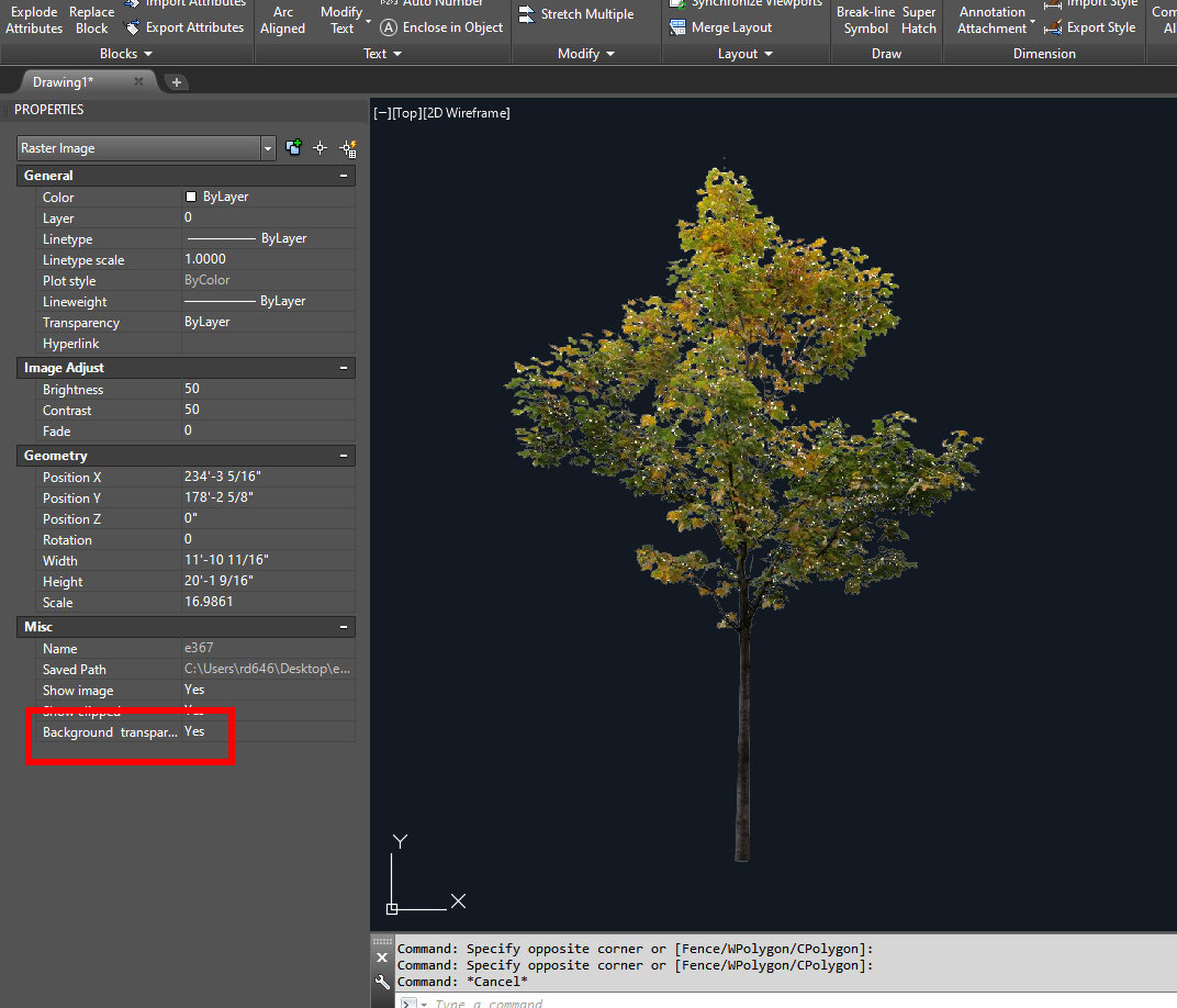

YES!! I created the plant image in photoshop and saved/ imported as you said- flawless. I had forgotten about the imageframe setting command. Great thing with the photoshop opacity values, they carry through into autocad, so I can see overlapping data and understory plants under the tree symbols. Thank you! test1.pdf1 point
In Photoshop, delete the white background, so only the tree remains, then save the tree as .png format. In Autocad, insert the tree image. Open the Properties palette and enable "Background Transparency". In the image below, I have also set the Imageframe variable to 0, so the image border is not visible.1 point
