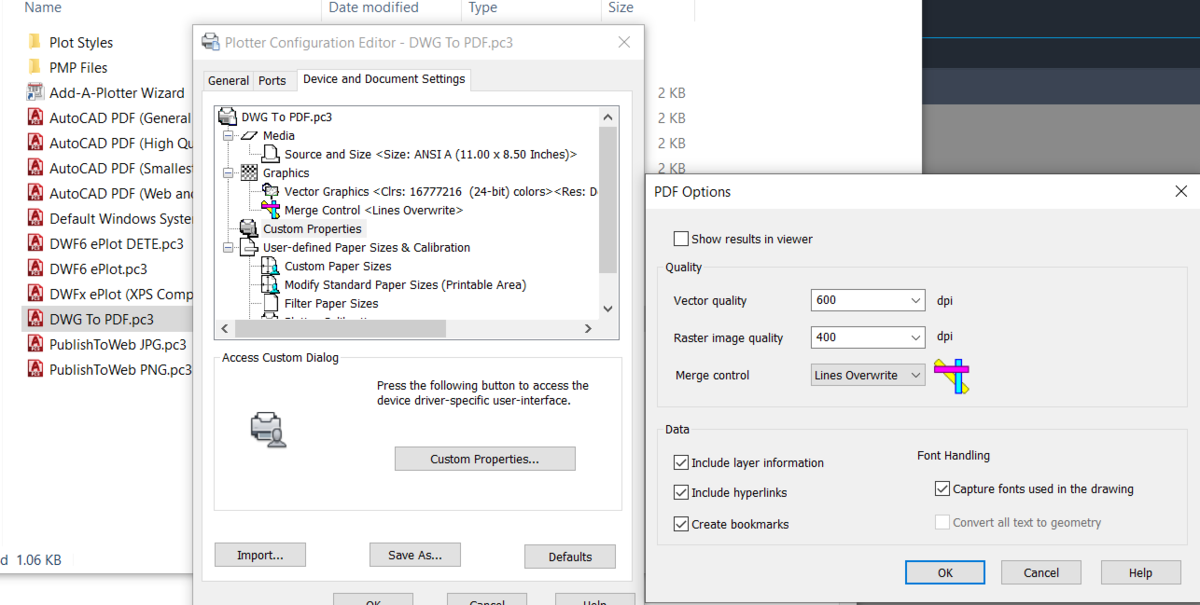

  5. Like cad64 have played with the dpi problem found for say an A1 sheet 200 dpi is fine, in dwg to pdf its set to 600dpi try say 400 as a minimum 180 dpi. The dpi is like a x squared increase in size.
    1 point
  6. It could be that you have your PDF settings cranked up too high. You may need to tweak your settings to make sure you're getting the best quality at a reasonable file size. It could also have something to do with the type of text you're using. I have found that Arial causes pdf size to increase, especially if you have an entire sheet filled with notes. It can really bloat the pdf.
