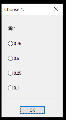

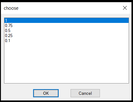

  1. A couple of choices rather than initget (if (not AH:Butts)(load "Multi Radio buttons.lsp")) (if (= but nil)(setq but 1)) (setq ans (atof (nth 0 (ah:butts but "v" '("Choose 1: " "1" "0.75" "0.5" "0.25" "0.1" ))))) remembers last picked. Another by lee-mac (if (not LM:LISTBOX)(LOAD "ListBoxV1-2.lsp") (setq lst (list "1" "0.75" "0.5" "0.25" "0.1" )) (LM:LISTBOX "choose" lst 2)
