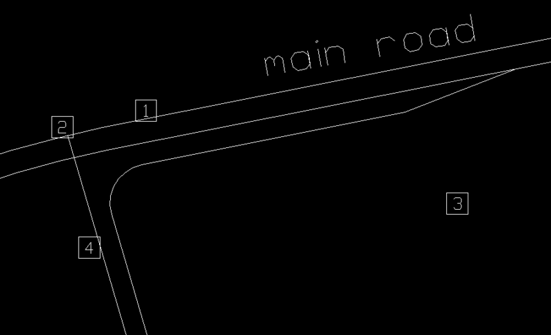

  10. Have a look at image for pick sequence. Ok lets walk before we run make it work for 1 lane 1st then consider dual lanes.
