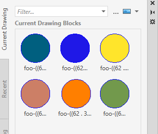

  5. Post a sample drawing of what you're trying to accomplish ... perhaps this will help you? (defun c:foo (/ b c d p) ;; RJP » 2020-01-24 (defun _foo (c / r) (entmake (list '(0 . "BLOCK") '(100 . "AcDbEntity") '(67 . 0) '(8 . "0") '(100 . "AcDbBlockReference") (cons 2 (setq r (strcat "foo-" (vl-princ-to-string c)))) '(10 0. 0. 0.) '(70 . 0) ) ) (entmake (append '((0 . "HATCH") (100 . "AcDbEntity") (8 . "hatch") (100 . "AcDbHatch") (10 0. 0. 0.) (210 0. 0. 1.) (2 . "SOLID") (70 . 1) (71 . 0) (91 . 1) (92 . 1) (93 . 1) (72 . 2) (10 0. 0. 0.) (40 . 0.5) (50 . 0.) (51 . 6.283185307179588) (73 . 1) (97 . 0) (75 . 1) (76 . 1) (98 . 1) (10 0. 0. 0.) (450 . 0) (451 . 0) (460 . 0.) (461 . 0.) (452 . 0) (462 . 0.) (453 . 2) (463 . 0.) (63 . 5) (421 . 255) (463 . 1.) (63 . 2) (421 . 16776960) (470 . "LINEAR") ) c ) ) (entmake (append '((0 . "CIRCLE") (100 . "AcDbEntity") (67 . 0) (8 . "0") (62 . 5) (100 . "AcDbCircle") (10 0. 0. 0.) (40 . 0.5) ) c ) ) (entmake '((0 . "ENDBLK") (100 . "AcDbBlockEnd") (8 . "0"))) (princ) r ) (if (setq c (acad_truecolordlg 1)) (while (and (setq p (getpoint "\nPick center point: ")) (or d (setq d (getdist p "\nPick radius: "))) (setq b (_foo c)) ) (entmakex (list '(0 . "INSERT") '(100 . "AcDbEntity") '(67 . 0) (cons 8 b) '(100 . "AcDbBlockReference") (cons 2 b) (cons 10 p) (cons 41 (* 2 d)) (cons 42 (* 2 d)) (cons 43 (* 2 d)) '(50 . 0.0) ) ) ) ) (princ) ) Will create circle blocks with different colored hatches.
