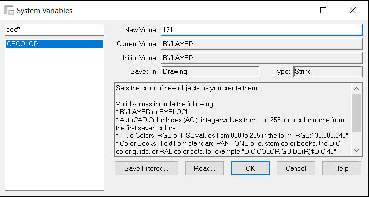

  3. (setvar 'cecolor "1") If you got to "Express" Click tools then System variable editor, it gives details about Autocad system variables its a big list so experience comes in. See image, note its a string not a number "171" ps 1 is red
