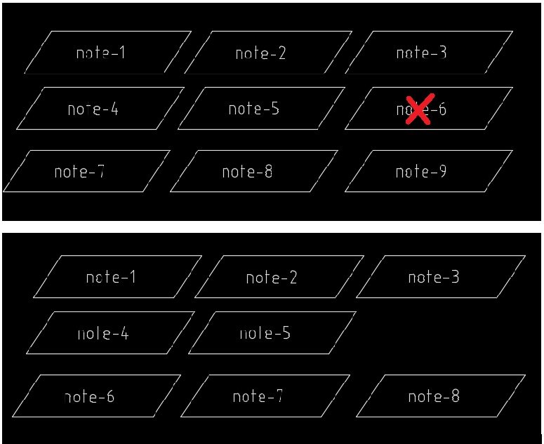

  4. don't worry , I can keep myself busy I just made a block with one attribute and put a text in it note-1 , note-2 etc. You select the note you want to delete (you must select the attribute) , it then read the number (in my example the number is 6) and then it deletes note six and renumbers the attributes higher than 6 so note-7 to note-9 will become note-6 to -8. NoNo.dwg
