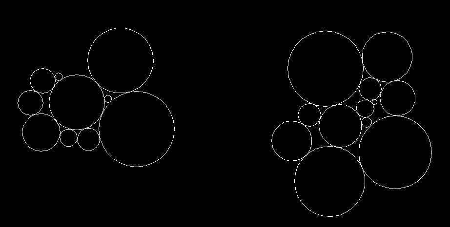

  11. For me pick point, use ssget "F" actually a polygon keep increasing till ssget find 2 circles then like marko use TTR with random radius. The approx. tan point is circle cen to picked point intersection. Interesting idea have done a few random patterns including a 3d tree ball of leaves. Try this includes 1st 2 circles, note it seems to work as it tries to find only 2 circles so if it misses keeps going no real check for after 50. Circles should be radius 1 to 30. Big circle be a little away small up closer. Note the Briscad polygon difference, need to find the check what am I running know about product key but Briscad does not like something when using it. ;; Rand - Lee Mac ;; PRNG implementing a linear congruential generator with ;; parameters derived from the book 'Numerical Recipes' (defun LM:rand ( / a c m ) (setq m 4294967296.0 a 1664525.0 c 1013904223.0 $xn (rem (+ c (* a (cond ($xn) ((getvar 'date))))) m) ) (/ $xn m) ) (defun LM:randrange (a b) (+ (min a b) (* (LM:rand) (abs (- a b)))) ) ; Adds a random radius circle berween 2 existing circles. ; By AlanH March 2020 info@alanh.com.au (defun c:3rdcirc (/ pt obj1 obj2 obj3 inc cen intpt1 intpt2 rad ss) (vl-load-com) (setq rad (fix (1+ (LM:randrange 1 30)))) (command "circle" (getpoint "\pick point for 1st circle") rad) (command "circle" (getpoint "\pick point for 2nd circle") rad) (while (setq pt (getpoint "\npick a point Enter to exit")) (setq inc 1.0) (setq rad (fix (1+ (LM:randrange 1 30)))) (while (< inc 50) (command "polygon" 20 pt "I" inc) ; Autocad ; (command "polygon" 20 pt (polar pt 0.0 inc)) ; Briscad (setq co-ord (mapcar 'cdr (vl-remove-if-not '(lambda (x) (= (car x) 10)) (entget (entlast))))) (setq ss (ssget "F" co-ord (list (cons 0 "circle")))) (if (and (/= ss nil) (= (sslength ss) 2)) (progn (setq inc 51) (command "erase" (entlast) "") (setq obj1 (vlax-ename->vla-object (ssname ss 0))) (setq cen (vlax-get Obj1 'Center)) (command "line" cen pt "") (setq obj3 (vlax-ename->vla-object (entlast))) (setq intpt1 (vlax-invoke obj3 'intersectWith obj1 acExtendNone)) (command "erase" (entlast) "") (setq obj2 (vlax-ename->vla-object (ssname ss 1))) (setq cen (vlax-get Obj2 'Center)) (command "line" cen pt "") (setq obj3 (vlax-ename->vla-object (entlast))) (setq intpt2 (vlax-invoke obj3 'intersectWith obj2 acExtendNone)) (command "erase" (entlast) "") (command "circle" "TTR" intpt1 intpt2 Rad) ) (progn (setq inc (+ inc 1.0)) (command "erase" (entlast) "") ) ) ) ) (princ) ) (c:3rdcirc)
    1 point
  12. Here in attachment is something I revised recently... Take a look at the code, it also deals with circles tangents, but in various combinations of LINE, CIRCLE and POINT as reference objects... Look at Lee's ci1xci2 sub (trans) version that I slightly modified - I would use that sub instead of your version... Link : http://www.theswamp.org/index.php?topic=39567.msg449135#msg449135 HTH., M.R. (Also worth noting : There is command CIRCLE - 3p (tan, tan, tan) or CIRCLE - TTR (tan, tan, radius))...

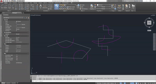

  13. Another one here. It's single pick but will keep the polyline intact.
    1 point
  14. I didn't thought you'd be doing that. I simply thought it was just an arc. A better way to approach that is if you select all lines or curves) that "goes below" (or doesn't change), then select the one polyline to curve or "go above" as shown in your desired result. With the help of LM:intersectionbetweensets by Lee Mac, this can be accomplished as shown in the gif below Assuming that the "purple" lines doesn't go too close the vertex of the polyline to "go above", the code to do as such is below: ;; Intersections Between Sets - Lee Mac ;; Returns a list of all points of intersection between objects in two selection sets. ;; ss1,ss2 - [sel] Selection sets (defun LM:intersectionsbetweensets ( ss1 ss2 / id1 id2 ob1 ob2 rtn ) (repeat (setq id1 (sslength ss1)) (setq ob1 (vlax-ename->vla-object (ssname ss1 (setq id1 (1- id1))))) (repeat (setq id2 (sslength ss2)) (setq ob2 (vlax-ename->vla-object (ssname ss2 (setq id2 (1- id2)))) rtn (cons (LM:intersections ob1 ob2 acextendnone) rtn) ) ) ) (apply 'append (reverse rtn)) ) ;; Intersections - Lee Mac ;; Returns a list of all points of intersection between two objects ;; for the given intersection mode. ;; ob1,ob2 - [vla] VLA-Objects ;; mod - [int] acextendoption enum of intersectwith method (defun LM:intersections ( ob1 ob2 mod / lst rtn ) (if (and (vlax-method-applicable-p ob1 'intersectwith) (vlax-method-applicable-p ob2 'intersectwith) (setq lst (vlax-invoke ob1 'intersectwith ob2 mod)) ) (repeat (/ (length lst) 3) (setq rtn (cons (list (car lst) (cadr lst) (caddr lst)) rtn) lst (cdddr lst) ) ) ) (reverse rtn) ) (defun c:linearc ( / *error* above activeundo acadobj adoc ang arc below msp rad) (defun *error* ( msg ) (setvar "CMDECHO" cmd) (vla-EndUndoMark adoc) (if (not (wcmatch (strcase msg T) "*break*,*cancel*,*exit*")) (princ (strcat "Error: " msg)) ) ) (setq acadobj (vlax-get-acad-object) adoc (vla-get-ActiveDocument acadobj) msp (vla-get-ModelSpace adoc) activeundo nil) (if (= 0 (logand 8 (getvar "UNDOCTL"))) (vla-StartUndoMark adoc) (setq activeundo T)) (princ "\nSelect curves that goes below: ") (if (setq cmd (getvar "CMDECHO") below (ssget '((0 . "LINE,*POLYLINE,CIRCLE,ARC,ELLIPSE,SPLINE"))) ) (progn (setq rad (progn (initget 1) (getreal "\nSpecify radius of arc: "))) (while (progn (setq above (entsel "\nSelect curve that goes above: ")) (cond ((null above) (princ "\nNothing selected")) ((not (wcmatch (cdr (assoc 0 (entget (car above)))) "LINE,*POLYLINE,CIRCLE,ARC,ELLIPSE,SPLINE")) (princ "\nObject is not a curve") ) ((setq above (car above)) nil) ) ) ) (setvar "CMDECHO" 0) (foreach x (vl-sort (LM:intersectionsbetweensets below (ssadd above)) '(lambda (a b) (< (vlax-curve-getParamAtPoint above a) (vlax-curve-getParamAtPoint above b) ) ) ) (if (< (* 0.5 pi) (setq ang (angle '(0 0 0) (vlax-curve-getFirstDeriv above (vlax-curve-getParamAtPoint above x)))) (* 1.5 pi) ) (setq ang (+ pi ang)) ) (setq arc (entmakex (list '(0 . "ARC") (cons 10 x) (cons 40 rad) (cons 50 ang) (cons 51 (+ pi ang)) ) ) ) (command "_break" above (polar x ang rad) (polar x (+ pi ang) rad)) (setq above (entnext arc)) ) (setvar "CMDECHO" cmd) ) ) (if activeundo nil (vla-EndUndoMark adoc)) (princ) ) The arc is drawn under the assumption that the intersection point is a straight line, and thus the angle between the arc is 180. If you were to select it on a circle, you'll notice that the arc and line won't be in line, but I think this will be quite enough with what you need to achieve. Thanks, Jonathan Handojo
    1 point
