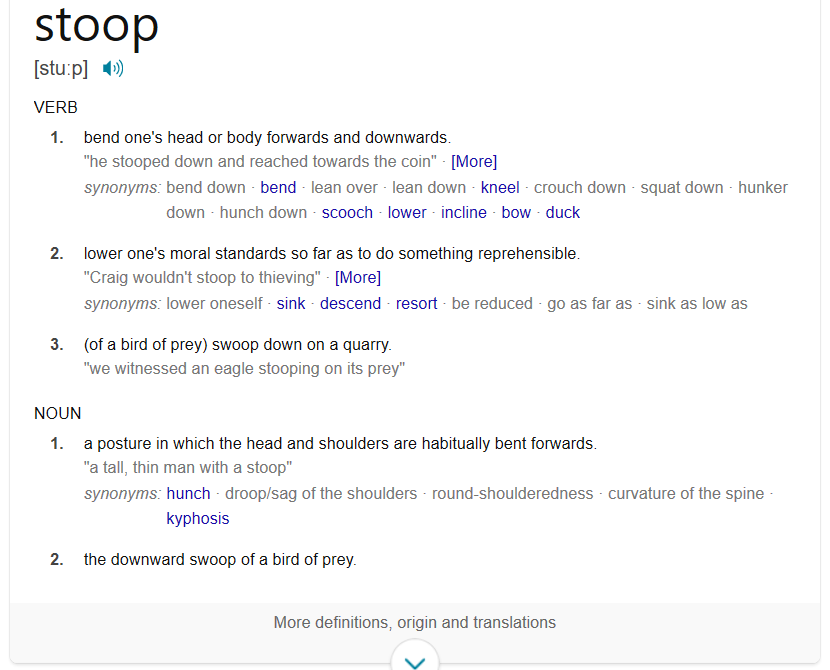

  5. it has been a while to this page maybe 6 years after I am coming back but I made a typo it is "stop" but I am happy it made some to laugh during covid 19 ok here we go 2020 www.lee-mac.com :: :: "ctx" to Copy | "stx" to Swap :: Command: STX Formatting retained: Yes Select text to swap [Settings/Exit] <Exit>: se Retain mtext formatting? [Yes/No] <Yes>: n Formatting retained: No Select text to swap [Settings/Exit] <Exit>: Formatting retained: No And text to swap it with [Settings/Exit] <Exit>: Error: no function definition: VLAX-ENAME->VLA-OBJECT Command: this is the error message I am getting. my typing is bad if there is any error forgive me. thanks Stoop
