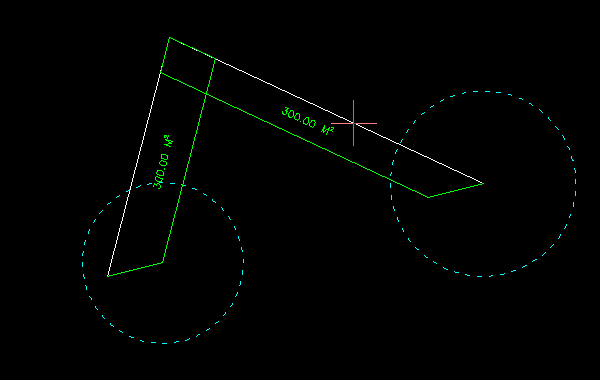

  2. I'm afraid, you would put in an area that is too large, large area for expansion (case two adjacent angles: α + β > pi), or trim area (case two adjacent angles: α + β < pi). So, I added a warning. I have fixed this lisp. Extend_Trim_Area(DHT).lsp
    2 points
  3. $0.02 if both sides parallel 90d, manually calculation, Area= Width x Height, where A = W x H, eg: required A= 20M ,known Height=4, ie: offset, W=A/H = 20/4 = 5.00 either offset or move along axis ortho ... (defun c:tt ( / ) (initget 7) (and (setq a (getreal "\nEnter Area ")) ; input area (setq s (ssget "_:S:E+." '((0 . "LWPOLYLINE,LINE")))) ; pick line single selection (setq en (ssname s 0)) (setq p (getpoint "\npick side.. ")) ; pick offset side (if (< (setq ep (vlax-curve-getEndParam en)) 2) ; check whether only 2 points (progn (vl-cmdf "_OFFSET" ; offset the line (/ a (vlax-curve-getDistAtParam en ep)) ; calculate X , A divided Y en p "" ) (princ "\nDone.") ) (princ "\nSingle line!!") ) ) (princ) ) another 2 different scenarios which open & close polyline

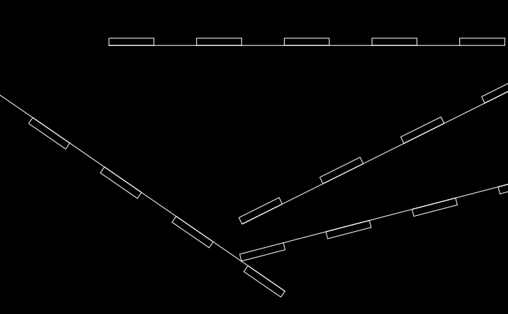

  17. Your using the near end so why not add the angle to the block pt so line is at any angle no need to check. I would make the pick line the rail edge rather than centreline. had a go as per PM will add this one as well. I rewrote the block to be a 1x1 sq so it scales the size of the picket. Ver2 would use multigetvals.lsp. (vl-load-com) (defun c:rlayout ( / vars impmet picketthk maxoc num numcores post_oc) (defun *error* ( m ) (and vars (mapcar 'setvar '(osmode pickbox aunits angdir ) vars)) (princ m) (princ) ) ;;; impet1 change this for Imperial or Metric - 1=Imperial, 2.54=cm 25.4=mm, etc... (setq vars (mapcar 'getvar '(osmode pickbox aunits angdir)) impmet 1 picketthk (* impmet 1.) ) (leftside) (setq num 0 maxoc 151. numcores (+ 2 (fix (/ (distance pt1 pt2) maxoc))) post_oc (/ (distance pt1 pt2) (1+ (fix (/ (distance pt1 pt2) maxoc)))) len 75.0 wid 12.0 ) (setvar 'aunits 3) (setvar 'osmode 0) (setvar 'angdir 0) (repeat numcores (command-s "._INSERT" "1sq" (polar pt1 ang (* post_oc num)) len wid ang) (setq num (1+ num)) ) (mapcar 'setvar '(osmode pickbox aunits angdir) vars) (princ) ) (defun leftside ( / tp1 tpp1 pt3) (setq tp1 (entsel "\nSelect a line : ")) (setq tpp1 (entget (car tp1))) (setq pt1 (cdr (assoc 10 tpp1))) (setq pt2 (cdr (assoc 11 tpp1))) (setq pt3 (cadr tp1)) (setq d1 (distance pt1 pt3)) (setq d2 (distance pt2 pt3)) (if (> d1 d2) (progn (setq temp pt1) (setq pt1 pt2) (setq pt2 temp) ) ) (setq ang (angle pt1 pt2)) ) You have an error in working out the 1st point so some hints as the code I am using is confidential I have not fully rewritten. c-c (+ gap wid) (setq dist (distance pt1 pt2)) (setq num (- (fix (/ dist c-c)) 1)) (setq endd (/ (- dist (* num c-c)) 2.0)) Balcony2.mp4
