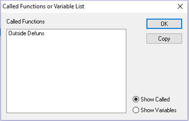

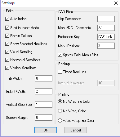

  5. can't licence lisplink any more but think I still can show you the screen you want :
