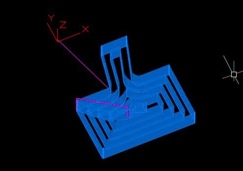

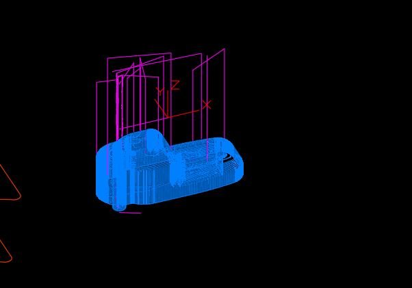

  11. I wrote this simple backplot lisp to check gcode files I am writing via lisp routines. It is very basic and set up for 3 axis Fanuc mill type Gcode. It is currently only set up for xy plane arcs and G00, G01, G02, G03 feed moves. Other GCodes are filtered out and ignored. It would not be difficult to modify it for use with 3d printer type gcodes if you wanted to. Its not the cleanest code, and there are probably some mistakes in it, but so far it has been pretty reliable. Feel free to use or modify it. BackPlot.lsp

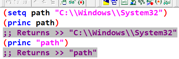

  20. I don't understand how that code can work PATH /= "PATH". Graphic to help you understand:

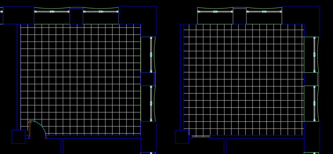

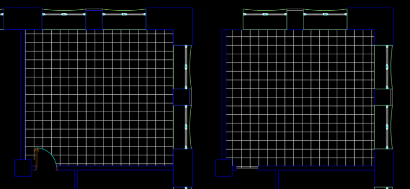

  24. I would have thought the room size is wrong it should be calculated without the door arc This is a big amount if talking flooring material I have not seen carpet missing at the doorway. Looking at the drawing need a line drawn across the doorway on a no plot layer, then turn the layer doors off.

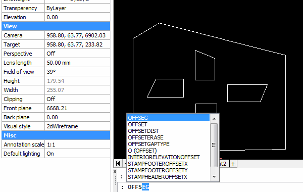

  25. another offset concept 2 options ;; Offset segment for polyline (defun c:OFFSEG ( / *error* $ aa aa* _angle ang ax en ep force_closed i ip k l l1 lst n p p1 px s sc sp vs ) ;;hanhphuc 01.04.2020 ;*offseg_area* - global variable (setq force_closed 1 ;; setting closed=1 , open=0 *error* '((msg) (princ " *cancel*")) _angle '((en x) (angle '(0. 0. 0.) (vlax-curve-getFirstDeriv en x))) ) (while (setq s (ssget "_:S:E:L+." '((0 . "LWPOLYLINE")))) (and (setq en (ssname s 0) p1 (osnap (cadr (grread t 13)) "_nea")) (not (vla-put-closed (vlax-ename->vla-object en) force_closed )) (setq p (trans p1 1 0) i (fix (vlax-curve-getparamatpoint en p)) ep (vlax-curve-getEndParam en)) (>= ep 2) (setq ang (mapcar '(lambda (x) (_angle en x) ) (cond ( (< i 1)(list (1- ep) (1+ i)) ) ( (>= i (1- ep)) (list (1- i) 0)) ( (list (1- i) (1+ i)) ) ) ) ) (setq *offseg_area* (ureal 5 "" "\nEnter area " (cond ( *offseg_area* ) ( 0.000 ) ) ) ) (princ "\nStretching segment.. \n") (while (and p (mapcar 'set '(k p) (grread t 13)) (= 5 k) (vl-consp p) (setq p1 (trans p 1 0)) ) (redraw) (if (vl-some 'not (setq l (mapcar '(lambda (a b / p) (list (setq p (vlax-curve-getPointAtParam en b)) (inters p (polar p a 1.0) p1 (polar p1 (_angle en i) 1.0 ) nil ) ) ) ang (list i (1+ i)) ) l1 (apply 'append l) n (length l1) lst (mapcar '(lambda (x) (nth x l1)) '(0 1 3 2)) ) ) (setq p nil) (if (= *offseg_area* 0.0) (progn (grvecs (apply 'append (mapcar '(lambda (x) (cons (car x) (mapcar '(lambda (x) (trans x 0 1) ) (cdr x) ) ) ) (cons (cons 2 (mapcar 'cadr l)) (mapcar '(lambda (x) (cons 2 x)) l ) ) ) ) ) (princ (apply 'strcat (setq $ (list "\rArea = " (rtos (setq AA* (abs (math:area lst))) 2 2 ) " M\U+00B2 " ) ) ) ) ) (princ (strcat "\rSelect offset side.. ")) ) ) ); while (if (and (/= *offseg_area* 0.00) (setq ip (apply 'inters (apply 'append (reverse (cons '(nil) l))) ) ) (setq AA (abs (math:area (list (car l1) ip (caddr l1))) ) ) (setq Ax ((if (minusp (- AA (abs (math:area (list (cadr l1) ip (cadddr l1)))) ) ) + - ) AA *offseg_area* ) sc (sqrt (/ (abs Ax) AA)) lst (cons (car l1) (append (mapcar '(lambda (x) (polar ip (angle ip (x l1)) (* (distance ip (x l1)) sc ) ) ) (list car caddr) ) (list (caddr l1)) ) ) AA* (abs (math:area lst)) $ (list "\rArea = " (rtos AA* 2 2) " M\U+00B2 " ) ) (equal AA* *offseg_area* 1e-6) ) ;and (princ (apply 'strcat $ ) ) (progn (setq sp (mapcar '(lambda (x) (vlax-curve-getPointAtParam en x) ) (list i (1+ i)) ) px (mapcar '(lambda (` p a) (polar p a (` (/ *offseg_area* (abs (* (sin (- (cadr ang) (_angle en i))) (apply 'distance sp) ) ) ) ) ) ) (if (LM:Inside-p p en ) ;;; UCS some not working (list - +) (list + -)) sp ang ) ) (setq lst (if (= *offseg_area* 0.0) lst (list (car sp) (car px) (cadr px) (cadr sp) ) ) AA* (abs (math:area lst)) $ (list "\rArea = " (rtos AA* 2 2) " M\U+00B2 " ) ) ) ) ;if (if (or (equal AA* *offseg_area* 1e-6) (= *offseg_area* 0.0) ) (entmakex (vl-list* '(0 . "LWPOLYLINE") '(100 . "AcDbEntity") '(100 . "AcDbPolyline") '(70 . 0) (cons 90 (length lst)) (mapcar '(lambda (x) (cons 10 x)) lst) ) ) (if (not (= *offseg_area* 0)) (alert (strcat "Exceed chamfer limit!\nMax = " (if ip (rtos AA 2 2) "???") "\ M\U+00B2" ) ) ) ) ) ) (princ) ) ;This function is freeware courtesy of the author's of "Inside AutoLisp" for rel. 10 ;published by New Riders Publications. ;This credit must accompany all copies of this function. ;;;October 19, 2004 added function chkkwds (see description at end of file) ;* UREAL User interface real function ;* BIT (0 for none) and KWD key word ("" for none) are same as for INITGET. ;* MSG is the prompt string, to which a default real is added as <DEF> (nil ;* for none), and a : is added. ;* (defun ureal (bit kwd msg def / inp) (if def (setq msg (strcat "\n" msg " <" (if (eq (type def) 'REAL) (rtos def 2) (if (eq (type def) 'INT) (itoa def) def ) ) ">: " ) bit (* 2 (fix (/ bit 2))) ) (setq msg (strcat "\n" msg ": ")) ) (initget bit kwd) (setq inp (getreal msg)) (if inp inp def ) ) ;;----------------------=={ Inside-p }==----------------------;; ;; ;; ;; Predicate function to determine whether a point lies ;; ;; inside a supplied LWPolyline. ;; ;;------------------------------------------------------------;; ;; Author: Lee Mac - www.lee-mac.com ;; ;; Using some code by gile (as marked below), thanks gile. ;; ;;------------------------------------------------------------;; ;; Arguments: ;; ;; pt - 3D WCS point to test ;; ;; ent - LWPolyline Entity against which to test point ;; ;;------------------------------------------------------------;; ;; Returns: T if supplied point lies inside supplied LWPoly ;; ;;------------------------------------------------------------;; (defun LM:Inside-p ( pt ent / _GroupByNum lst nrm obj tmp ) (defun _GroupByNum ( l n / r) (if l (cons (reverse (repeat n (setq r (cons (car l) r) l (cdr l)) r)) (_GroupByNum l n) ) ) ) (if (= (type ent) 'VLA-OBJECT) (setq obj ent ent (vlax-vla-object->ename ent)) (setq obj (vlax-ename->vla-object ent)) ) (setq lst (_GroupByNum (vlax-invoke (setq tmp (vlax-ename->vla-object (entmakex (list (cons 0 "RAY") (cons 100 "AcDbEntity") (cons 100 "AcDbRay") (cons 10 pt) (cons 11 (trans '(1. 0. 0.) ent 0)) ) ) ) ) 'IntersectWith obj acextendnone ) 3 ) ) (vla-delete tmp) (setq nrm (cdr (assoc 210 (entget ent)))) ;; gile: (and lst (not (vlax-curve-getparamatpoint ent pt)) (= 1 (rem (length (vl-remove-if (function (lambda ( p / pa p- p+ p0 s1 s2 ) (setq pa (vlax-curve-getparamatpoint ent p)) (or (and (equal (fix (+ pa (if (minusp pa) -0.5 0.5))) pa 1e-7) (setq p- (cond ( (setq p- (vlax-curve-getPointatParam ent (- pa 1e-7))) (trans p- 0 nrm) ) ( (trans (vlax-curve-getPointatParam ent (- (vlax-curve-getEndParam ent) 1e-7)) 0 nrm) ) ) ) (setq p+ (cond ( (setq p+ (vlax-curve-getPointatParam ent (+ pa 1e-7))) (trans p+ 0 nrm) ) ( (trans (vlax-curve-getPointatParam ent (+ (vlax-curve-getStartParam ent) 1e-7)) 0 nrm) ) ) ) (setq p0 (trans pt 0 nrm)) (<= 0 (* (sin (angle p0 p-)) (sin (angle p0 p+)))) ;; LM Mod ) (and (/= 0. (vla-getBulge obj (fix pa))) (equal '(0. 0.) (cdr (trans (vlax-curve-getFirstDeriv ent pa) 0 nrm)) 1e-9) ) ) ) ) lst ) ) 2 ) ) ) ) ;math formula ; | x1 x2 x3 x4 xn.. | ; 1 | \/ \/ \/ \/ | ;Area= / | /\ /\ /\ /\ | ; 2 | y1 y2 y3 y4 yn.. | ; (defun math:area (l) ;hanhphuc (* (apply '- (mapcar '(lambda (x y) (apply '+ (mapcar '* (mapcar x l) (mapcar y (append (cdr l) (list (car l))))) ) ) '(car cadr) '(cadr car) ) ) 0.5 ) ) 1. if user input any value <> 0 the routine emulates just like OFFSET command does, just move the mouse which side to offset saving typing -ve 2. if user input zero, i.e= 0, activate dynamic mode like my previous post which has no restriction, free style parallel solution, W=A/H offset solution, scale A'=A x S² checking bug... 1.not for lines, convert+join+ purge vertices 2.single line N/A 3.not support bulged polyline or 3dpoly
