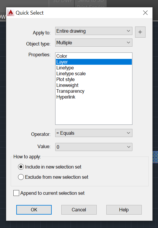

  5. One of the tools that we often forget is the Quick Select Tool. We can use Quick Select Tool to select the layers/ blocks that we want to isolate. This is extremely useful for those with specific layers, (Furniture Layer- Interior; Furniture Layer ref- Ceiling) because from there you can influence how the block behaves. An example would be using blocks for different specific sheets (Architectural- walls only, no furniture; Interior- Furniture only no lighting; Lighting Plan, Furniture setting in dotted outline; and so on.) To access this tool, we can right click into the model space and pick it from the drop down list. Pick the one with the lightning and an arrow. Pick the drop-down to select an entire drawing, from the properties you may check the layers you want to change. Cheers, -Chris E., AllAboutcad.com
