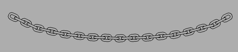

  2. Anyway, useful for making a chain look tidy.
    1 point
