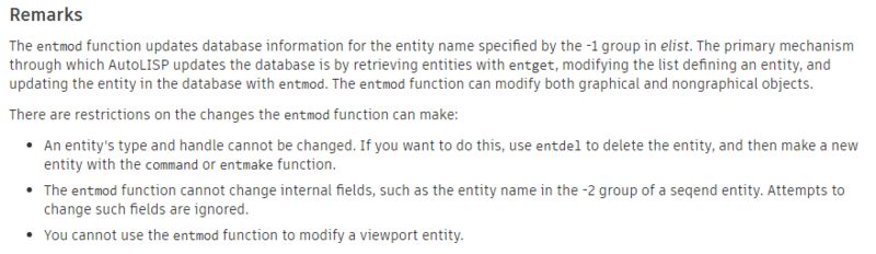

  1. Hi, From the help document and note the last sentence. ENTMOD FUNCTION
    2 points
