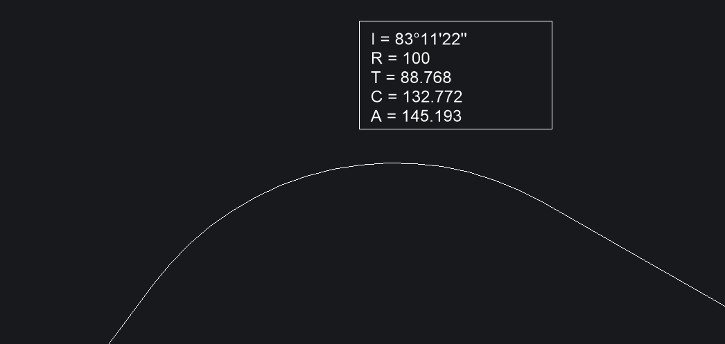

This was done about 1985 plus a couple of others. Its part of a bundle of programs will find an index page have a paper copy not a electronic will scan. Have the kerb 1/4 point setout somwhere, but and a big BUT it is not relevant having worked as a setout surveyor on roads you set out the 1/4 points based on a start and end peg that is offset from the back of the kerb so different values. Now use a GPS have smart offset calcs built in.1 point
Something I have been playing with. All welcome to add comment good or bad, a work in progress. Needs arc to be added. Probably change cords to use an ent and assoc 10. ; Pline properties use as a library function ; By Alan H july 2020 (defun cords (obj / co-ords xy ) (setq coordsxy '()) (setq co-ords (vlax-get obj 'Coordinates)) (setq numb (/ (length co-ords) 2)) (setq I 0) (repeat numb (setq xy (list (nth (+ I 1) co-ords)(nth I co-ords) )) (setq coordsxy (cons xy coordsxy)) (setq I (+ I 2)) ) ) (defun AH:chkcwccw (obj / objplnew area1 area2 minpoint maxpoint oldsnap) (setq oldsnap (getvar 'osmode)) (setvar 'osmode 0) (vla-GetBoundingBox obj 'minpoint 'maxpoint) (setq pointmin (vlax-safearray->list minpoint)) (setq pointmax (vlax-safearray->list maxpoint)) (setq dist (/ (distance pointmin pointmax) 20.0)) (vla-offset obj dist) (setq objplnew (vlax-ename->vla-object (entlast))) (setq area1 (vlax-get objplnew 'Area)) (vla-delete objplnew) (vla-offset obj (- dist)) (setq objplnew (vlax-ename->vla-object (entlast))) (setq area2 (vlax-get objplnew 'Area)) (vla-delete objplnew) (if (> area1 area2) (setq cw "Clockwise") (setq cw "Anti") ) (setvar 'osmode oldsnap) ) ; thanks to Lee-mac for this defun ; www.lee-mac.com ; 44 is comma (defun _csv->lst ( str / pos ) (if (setq pos (vl-string-position 44 str)) (cons (substr str 1 pos) (_csv->lst (substr str (+ pos 2)))) (list str) ) ) (defun plprops (obj txt / lst) (setq lst (_csv->lst txt)) (foreach val lst (cond ((= (strcase val) "LAY") (setq lay (vla-get-layer obj))) ((= (strcase val) "AREA")(setq area (vla-get-area obj))) ((= (strcase val) "START")(setq start (vlax-curve-getstartpoint obj))) ((= (strcase val) "END" (strcase txt))(setq end (vlax-curve-getendpoint obj))) ((= (strcase val) "LEN" (strcase txt))(setq len (vlax-get obj 'Length))) ((= (strcase val) "CW" (strcase txt))(AH:chkcwccw obj)) ((= (strcase val) "CORDS" (strcase txt))(CORDS obj)) ) ) ) (defun lineprops (obj txt / lst) (setq lst (_csv->lst txt)) (foreach val lst (cond ((= (strcase val) "LAY") (setq lay (vlax-get obj 'layer))) ((= (strcase val) "START")(setq start (vlax-get obj 'startpoint))) ((= (strcase val) "END" (strcase txt))(setq end (vlax-get obj 'endpoint))) ((= (strcase val) "LEN" (strcase txt))(setq len (vlax-get obj 'Length))) ) ) ) (defun circprops (obj txt / lst) (setq lst (_csv->lst txt)) (foreach val lst (cond ((= (strcase val) "LAY") (setq lay (vlax-get obj 'layer))) ((= (strcase val) "LEN" (strcase txt))(setq len (vlax-get obj 'Circumference))) ((= (strcase val) "RAD" (strcase txt))(setq rad (vla-get-radius obj))) ((= (strcase val) "CEN" (strcase txt))(setq cen (vlax-get obj 'Center))) ((= (strcase val) "AREA" (strcase txt))(setq area (vlax-get obj 'area))) ) ) ) ; starts here (setq ent (vlax-ename->vla-object (car (entsel "Pick Object ")))) ; do a check for object type then use a cond ; pick an example below ; many examples copy to command line for testing mix and match ; (plprops ent "LAY")(princ lay) ; (plprops ent "END")(princ end) ; (plprops ent "START")(princ start) ; (plprops ent "END,START")(princ end)(princ start) ; (plprops ent "AREA,LAY,END,START")(princ area)(princ lay)(princ end)(princ start) ; (plprops ent "START,AREA,LAY,CW")(princ start)(princ area)(princ cw) ; (plprops ent "start,END,CORDS,cw")(princ start)(princ end)(princ coordsxy)(princ cw) ; (plprops ent "CW")(princ cw) ; (plprops ent "AREA")(princ area) ; (plprops ent "CORDS")(princ coordsxy) ; (lineprops ent "len")(princ len) ; (lineprops ent "len,lay")(princ len)(princ lay) ; (lineprops ent "lay,end,start,len")(princ len)(princ lay)(princ start)(princ end) ; (circprops ent "lay,rad,area,cen")(princ lay)(princ rad)(princ area)(princ cen) ; (circprops ent "lay,rad")1 point
