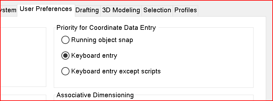

  4. Might want to check this in your Options... If you are using Dynamic Input, there are lots of available settings here to make it better comply with your aspirations.
    1 point
