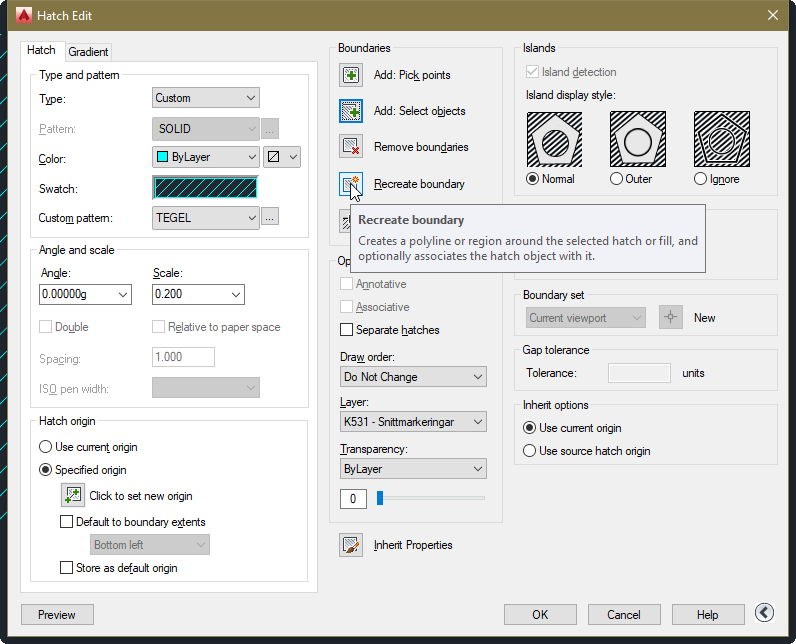

  2. Or just type 'HATCHGENERATEBOUNDARY' it is a core command.
    1 point
  3. 1 point
  4. There is a lisp that re-creates the boundary it may be in Express.
