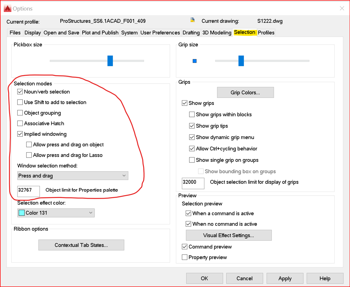

  2. Try SELECTIONAREA and/or PREVIEWFILTER if nothing else works. Or in Options-Selection as shown by Dadgad go to the "Visual Effects Settings...". A video or some images would be helpful, as would more detailed description of what you are doing and what's going on.

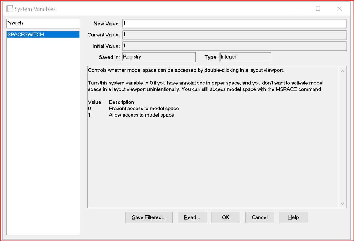

  3. You might want to check your SPACESWITCH variable, as shown in the screenshot from the SYSVDLG box. The OOTB default value is <1> maybe a coworker is messing with your ride and changed it to <0>? Hope not, but worth checking. You should check your settings in OPTIONS on the SELECTION tab too.
