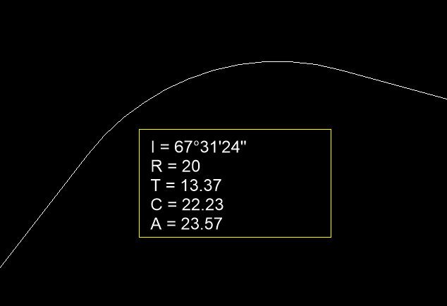

  2. Lol, I just love how no one is actually offering any help despite this being a ridiculously easy task, haha... Friend... "Good people always think twice before helping". There's a reason no one is helping you. As much as I'm being an annoying pest, this is all you're getting from me. The rest is on your own. (defun c:arcdetails ( / arc) (and (setq arc (car (entsel "\nSelect arc <exit>: "))) ((lambda (x / ep sp) (princ (strcat "\nArc Start Point: " (vl-prin1-to-string (setq sp (vlax-get x 'StartPoint))) "\nArc Mid Point: " (vl-prin1-to-string (vlax-curve-getPointAtParam x (* 0.5 (vlax-curve-getEndParam x)))) "\nArc End Point: " (vl-prin1-to-string (setq ep (vlax-get x 'EndPoint))) "\nArc Radius: " (rtos (vla-get-Radius x) 2) "\nArc Length: " (rtos (vla-get-ArcLength x) 2) "\nChord Length: " (rtos (distance sp ep) 2) ) ) ) (vlax-ename->vla-object arc) ) ) (princ) )

  4. Arc length is rad x theta (angle) or get length property. Chord distance pt1 -> pt2 Tangent (setq hyp (/ arcrad (cos (/ angdiff 2.0)))) (setq tang (sqrt (- (* hyp hyp) (* arcrad arcrad)))) Mid know tangent and angles E know 1/2 angle and rad distance -> mid

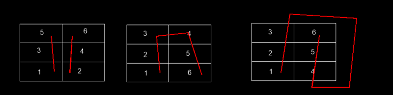

  5. The automation will depend on stuff like the lots are an individual pline then you could do something like start number then increment eg 1 then 3 5 7 by dragging a line over the lots in sequence stopping and starting would be necessary for a odd even arrangement. Using ssget "F" you could make what you have displayed may need a couple of options

  6. You mean something like this, have a go at writing something its just the arc properties, (entget (car (entsel "\Pick an arc"))) ((-1 . <Entity name: 82b6b060>) (0 . "ARC") (410 . "Model") (8 . "0") (10 116.242228560598 54.7129767932515 0.0) (40 . 20.0) (50 . 1.30406490850272) (51 . 2.48257365707))

  7. if in doubt... check Lee Mac... would this work? Incremental Array | Lee Mac Programming (lee-mac.com)
