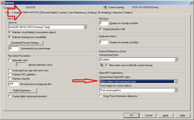

  4. Most likely a change to DEMANDLOAD System Variable, should be 3 IIRC. Or in Options>Open and Save>ObjectARX apps: Object detect and command invoke
