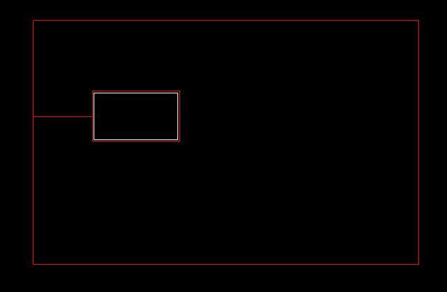

  2. I've made insets, that is, close-ups of areas in the main plan. It's not hard, just create a second, smaller viewport and put it somewhere to the side. If you need to edit something inside the smaller viewport, select it and press the Paper/Model button. For bonus style points, create an object-type frame with a circle, put another circle around the source area, draw a line center to center, and trim it to the frames. If you don't have an open space to put your inset, use a polygonal viewport for the main frame and draw it around the inset. Here's a diagram:
