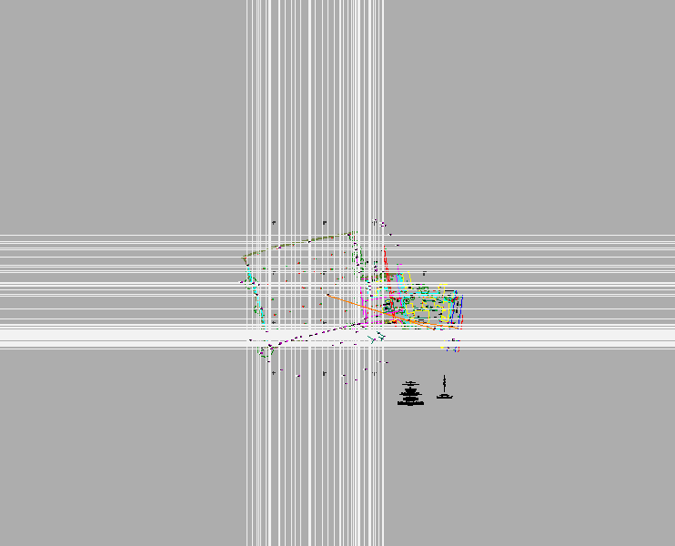

  6. Now you know how to set the size of a point in Absolute units, set the size to some huge value. Then when you Zoom Extents, all your line work will be at the centre of the screen, and the points will extend to the edges of the screen. You can now Erase all the points using a crossing window or a fence selection on one side of the points, safe in the knowledge that all your work would not be selected.

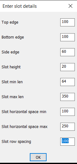

  9. Interesting can be done need some rules like edge clearance min and max length slot slot gap again min max obvious slot height slot spacing How many are variables. Lee-mac has a random number generator so can work out the min and max's. This uses the multi getvals.lsp in Cadtutor\downloads any one please feel free to use. If want to post random slot code, note "ans" is a list of strings. (if (not AH:getvalsm)(load "Multi Getvals.lsp")) (setq ans (AH:getvalsm (list "Enter slot details " "Top edge" 5 4 "100" "Bottom edge " 5 4 "100" "Side edge " 5 4 "60" "Slot height" 5 4 "20" "Slot min len" 5 4 "64" "Slot max len" 5 4 "350" "Slot horizontal space min " 5 4 "100""Slot horizontal space max " 5 4 "250" "Slot row spacing " 5 4 "100")))
