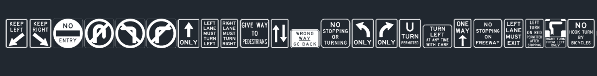

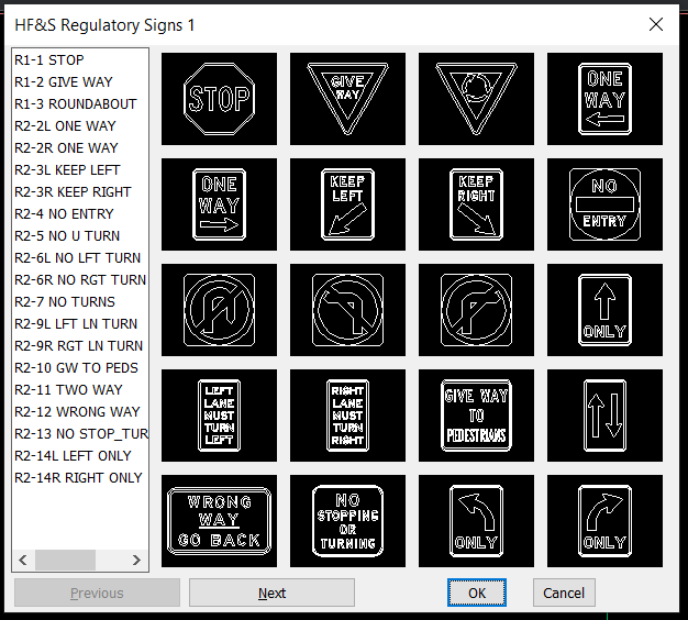

  6. I am lucky and here in AUS we have HFS fonts hundreds of traffic signs as TTF so a stop sign is say "A" using correct font. Anyway back to question, there may be a way of using a reactor to run a lisp that creates a mleader but puts correct block as answer. You would type say TSTOP or tgiveway tchevron1 I have used this before for doing offset fillet circles plus some other stuff Block insert is Bblockname. The reactor detects the error TSTOP is invalid command and pulls it apart so would know the block name is "STOP" I dont think making hundreds of mleaders styles is the way to go. Have you looked at selecting the sign from a dcl Here is the reactor code you could have a go using "T" rather than "F" will have a think about a mleader. You need to rewrite the defun filletrad for a mleader. ; Fillet rad uses Frad eg f100 puls the 100 from the F and then runs fillet ; BY Alan H 2015 ; great assistance from Lee-mac to make it work. ( (lambda nil (vl-load-com) (foreach obj (cdar (vlr-reactors :vlr-command-reactor)) (if (= "fillet-reactor" (vlr-data obj)) (vlr-remove obj) ) ) (vlr-command-reactor "fillet-reactor" '((:vlr-unknowncommand . fillet-reactor-callback))) ) ) (defun filletrad ( / rad) (setq rad (distof (substr com 2) 2)) (if (<= 0.0 rad) (progn (setvar 'filletrad rad) (vla-sendcommand fillet-reactor-acdoc "_.fillet ") ) ) ) (defun fillet-reactor-callback ( obj com ) (setq com (vl-string-translate "-" "." (strcase (car com)))) (cond ( (and (wcmatch com "~*[~F.0-9]*") (wcmatch com "F*") (wcmatch com "~F*F*") (wcmatch com "~*.*.*") ) ; and (filletrad) ) ) ; master cond ) ; defun (or fillet-reactor-acdoc (setq fillet-reactor-acdoc (vla-get-activedocument (vlax-get-acad-object))) )

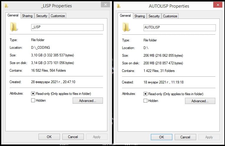

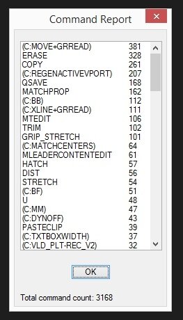

  8. My "_LISP" folder is catalogued with subfolders, where I had categorised different things related to AutoCAD development, so a bunch of .jpg .pdf .txt and mostly .lsp files. I use it when I have to build something from scratch, within it I have 'Pontentially used lisps' which contains 915 files at the moment. - bunch of .lsps with (C:test) calls which I don't load at my ACAD startup. My "AUTOLISP" folder is the .lsp-s loaded at startup, but it also contains subfolders with other extension file formats, like I keep folder with 450 font files within it. So roughly 550 .lsp and .vlx files which I keep for loading, where I cleared many of them in my acad.pgp loading list. To sum up I'm loading like 50 .lsp files at startup and maybe use 10-20 routines most oftenly. The thing is that its overwhelming to remember the function names and which routine does exactly what, so in my recent years I've tried to write the most generic useful routines for the work I do. In the past I had the idea to use command calls reactor which counts any commands I invoke while working on a project, so I could clear-up and consolidate lisps due the statistics I had. (back then I've actually created a topic here at CADTutor, where I turned it up into a game) Sample statistics attached for a project I was working on for 3 days. Now I'm recently doing something similar with JS for PhotoShop as a catalogued folder structure.. because of the work I have to do (and to automate for myself).
