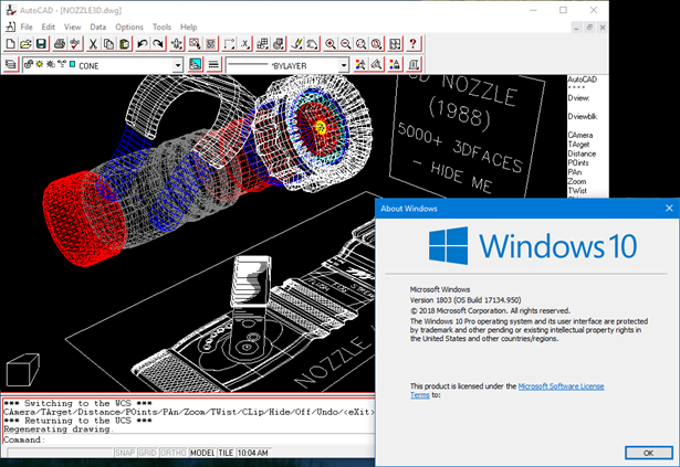

  3. Would you settle for R13 for Windows?
    1 point
