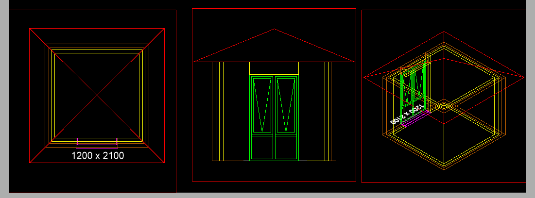

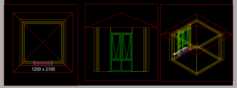

  4. I would like to see Plans and Elevations drawn in 6:30 let alone 3:30, the only way is to have like Revit,Architecture or another 3rd party program, still no way 3:30 = a box with a roof. It takes more than 3 minutes just to think about it. My attempt with Cadarc. start Sun May 2, 2021 09:22:08 stop Sun May 2, 2021 09:27:41 The time includes a initial setup of wall sizes etc the windows sizes are entered by the user, the object is full 3d with a whole cut through wall for window. Ps forgot this could be done in LT but very slow as there is no 3d solids a step by step process.
