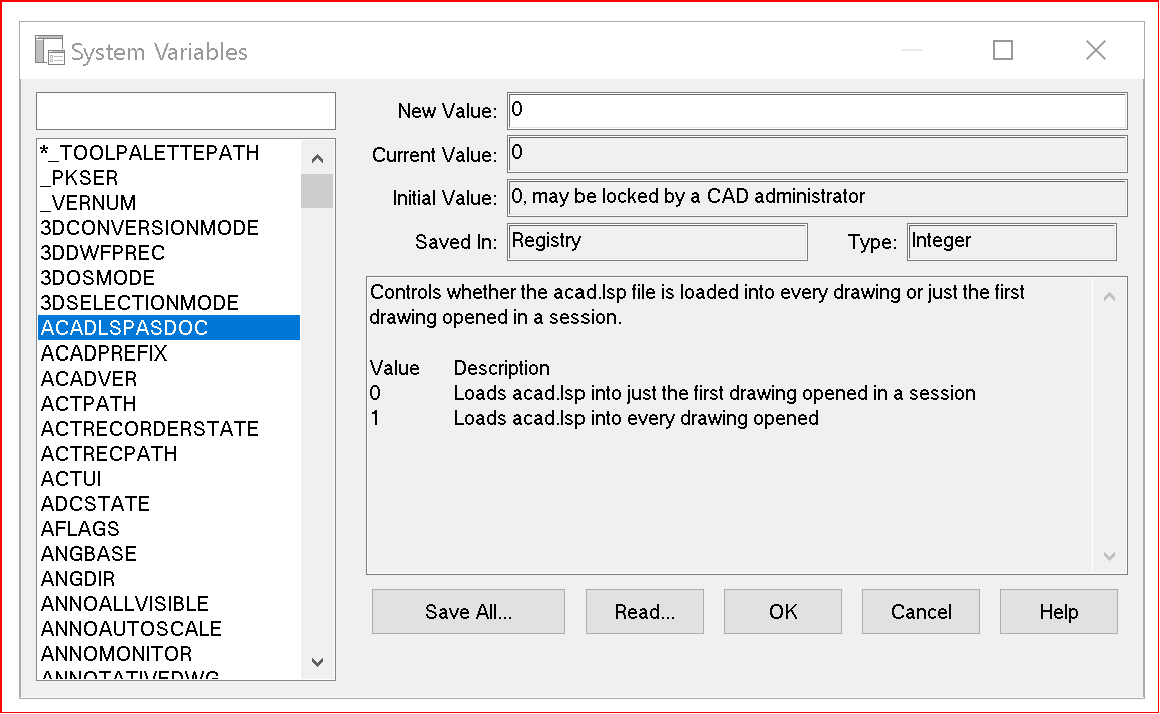

  1. Why not just load it with acad.lsp? As long as ACADLSPASDOC (System Variable) is set to it's initial value of 0 acad.lsp only loads when the first drawing is opened in a session. Don't use acaddoc.lsp to load it as it would load every time a drawing is opened which works well for most lisp routines.
    2 points

  4. Thanks for the replies guys. @Dadgad I'll do some reading about that sysvar... not sure if that will effect my LISP loading - I'll check it out. Definately ACADLSPASDOC could be the go! @Steven P Good suggestion for a quick work-around. I've gone with this solution for now, though I used : (setenv "aeccoreloaded" "Loaded") @tombu I think this is exactly what I was looking for, thank you! Thanks guys
    1 point
  5. @tombu nailed it, there is much to be said for consistency. I just stumbled across this in the SYSVDLG, and was about to ammend my earlier suggestion. Here is the screenshot.
    1 point

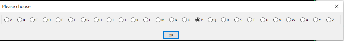

  10. For 1 (vlax-for block (vla-get-blocks (vla-get-activedocument (vlax-get-acad-object))) maybe do wcmatch i ie blk1002 ie found a block with 1002 in name ) for 2 I had a go using Multi radio buttons there is a option for A-Z its in the code examples at start of code, uses a defun to make the A-Z list its pushing the limits, use "H" horizontal option, when ran a variable BUT is set this is last item picked so default button will change to match last picked. (if (not AH:Butts)(load "Multi Radio buttons.lsp")) (if (not but)(setq but 16)) (setq ans2 (ah:butts but "h" (make_letters "Please choose" 65 26))) Multi radio buttons.lsp
    1 point
