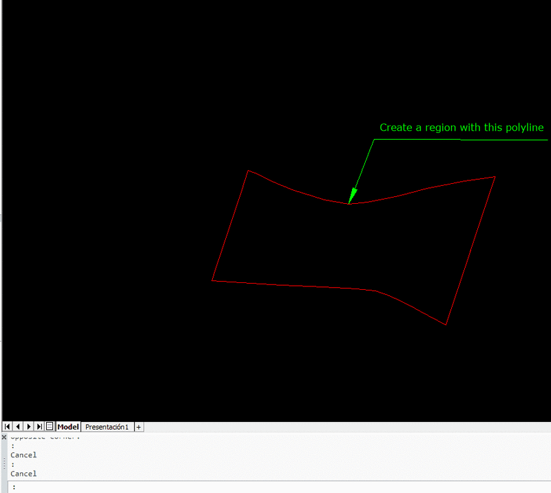

  1. Maybe use overkill on that polyline then see if that helps.
    2 points
  2. If you use the region command it gives you a clue as to why it won't work:
    1 point
  3. The mhupp command works fine, in fact the polyline in question has repeated vertices. I have created a program to remove duplicate vertices from polylines, but it is much easier to use the BOUNDARY command in this case.
    1 point
  4. Still works. maybe what your selecting isn't a poly or closed all the way. I know if you try to region a open poly in BricsCAD it just deletes it
    1 point
  5. Works for me. tho I have other lisp that have this already add (vl-load-com) vl-load-com is need with commands that start with vla, vlax, vlr or it will error out. (defun C:foo () (vl-load-com) (setq poly_p (entsel "\nSelecciona una parcela exterior: ")) (setq nombre_ent (car poly_p)) (setq obj_n (vlax-ename->vla-object nombre_ent)) (vlax-invoke (vla-get-modelspace (vla-get-activedocument (vlax-get-acad-object))) 'addregion (list obj_n)) (princ) )
