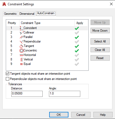

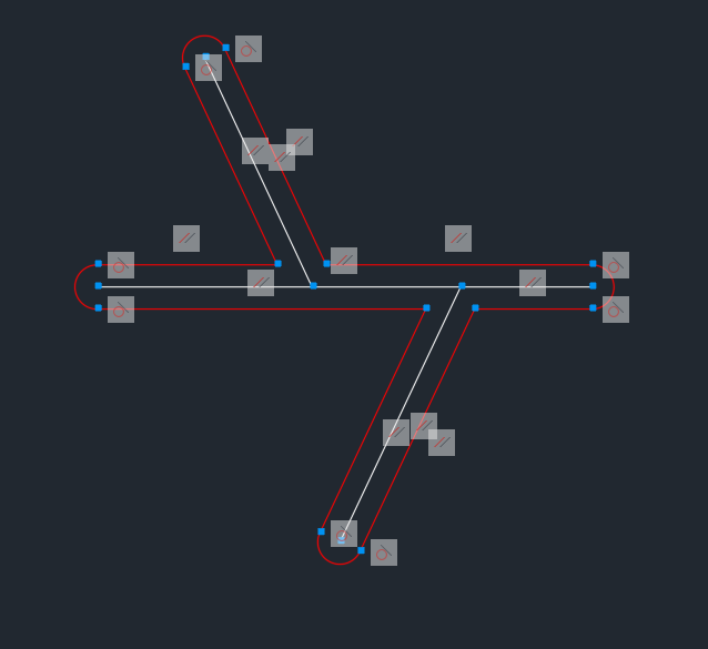

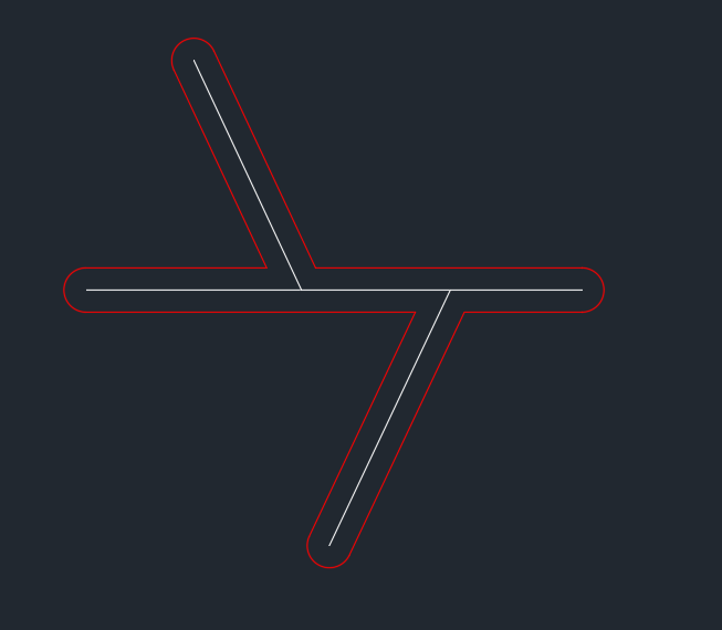

  4. Suppose this is your geometry: When you're done, use the AUTOCONSTRAINT command (or optionally go here). Go to Settings first, check the Coincident, Parallel, Tangent and Concentric while leaving the rest unchecked: Click OK and select the whole red and white curves and enter. Now you can move the white lines and the red ones will follow.
