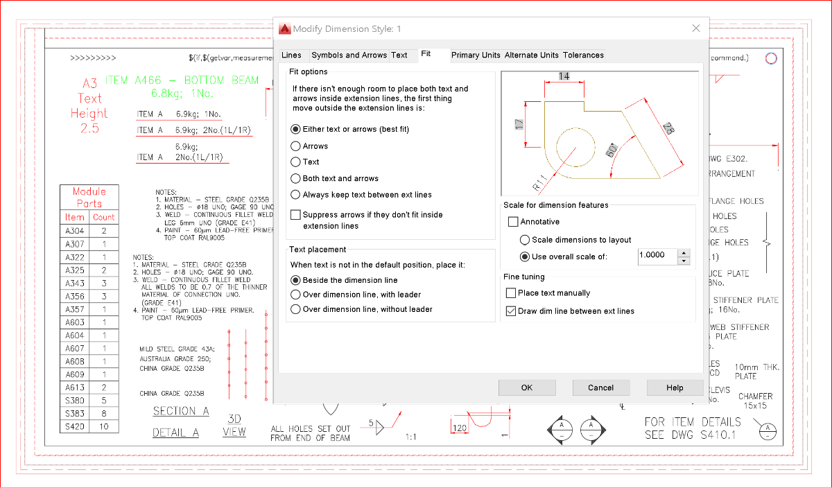

  3. If you are using nonassociative dimensions, and dimensioning in Paperspace, as I do. Go into MODIFY for your Dimstyle, and check on your FIT tab. I believe you want it as shown in the screenshot. Specifically the Scale for dimension features, select use overall scale of 1.
    1 point
