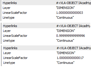

  6. Thank you! I didn't realize that these were not at a dim scale linear = 1 because my precision wasn't set as high. Thank you so very much.
    1 point

  10. That drawing had 5 dimensions that are not = to 1 linear scale. the two that I'm guessing you changed to 1.5 for testing. But the other three dimensions are not 1 either. These deviations wouldn't affect any real dimensions and could be ignored by adding a fuzz distance to the if statement. (if (= 1 (vla-get-LinearScaleFactor obj)) change to (if (equal 1 (vla-get-LinearScaleFactor obj) 0.001) or change them to linear scale factor of 1
    1 point
