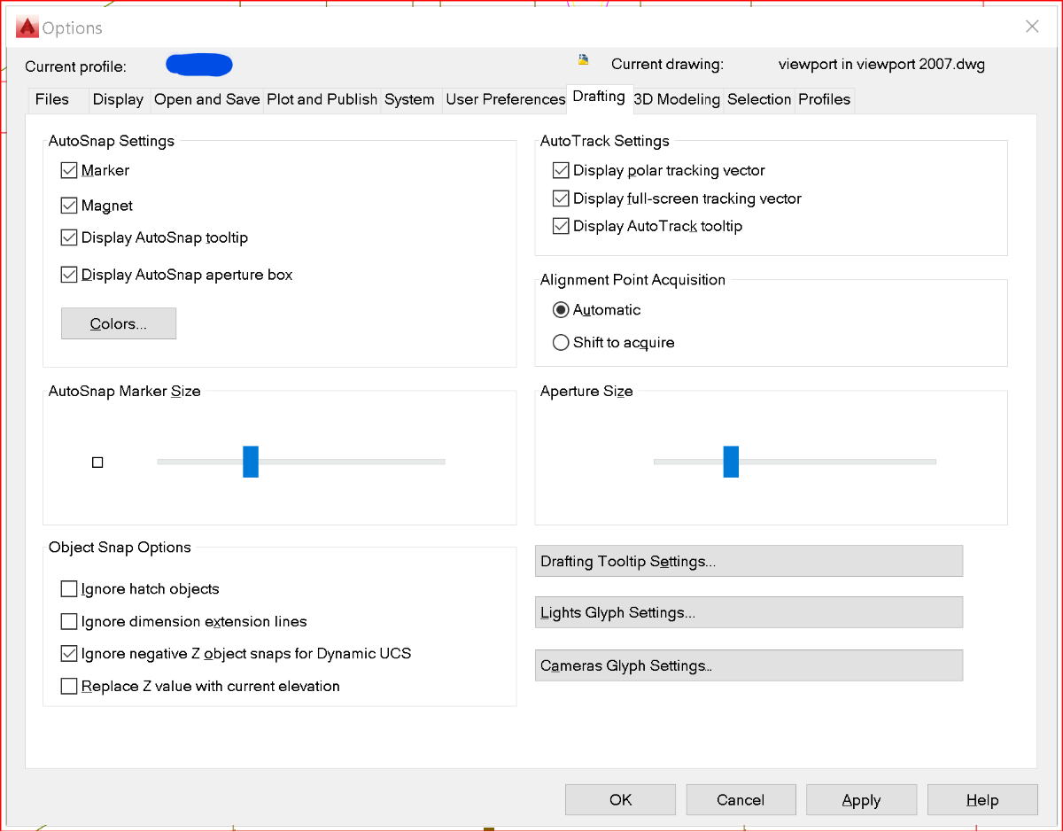

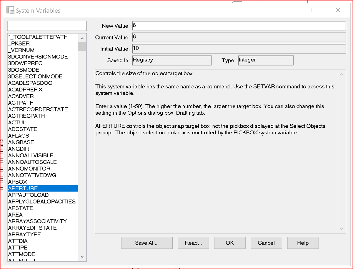

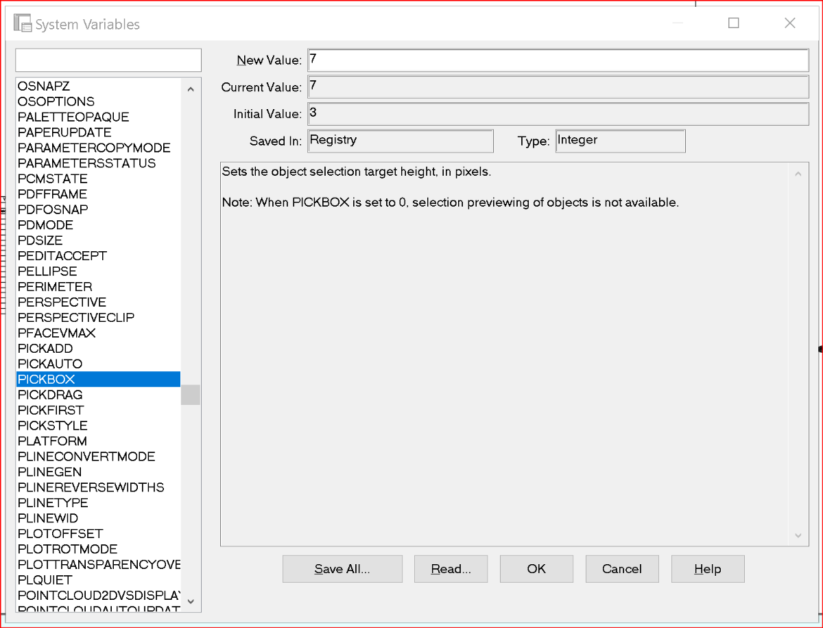

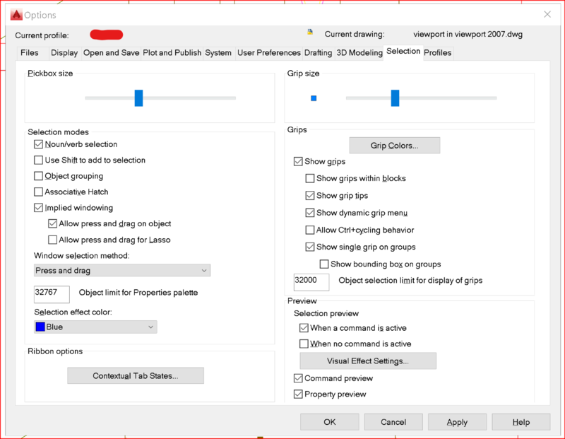

  9. You would probably be interested to go to OPTIONS and then look at the SELECTION and DRAFTING tabs to help you understand what the variables do.
    1 point
