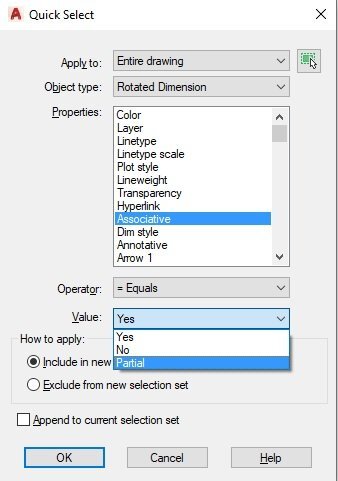

All the dims you have highlighted are only partially associated, that is the problem with using dimensions in paper space, you have to be 1000% positive that you are picking a point of geometry and not picking the node point or some other part of one of your other dimensions. Autocad cannot work out what the dims are if you are selecting one end in modelspace and the other end is in paperspasce. It helps a bit to turn of ALL unneccessary osnaps (like node) and then also make sure you are hovering over geometry when dimensioning and not in an area close to the ends of other dims.1 point
