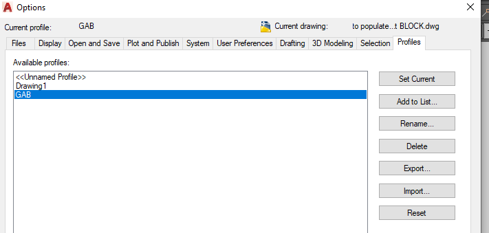

  5. And at the last right label "PROFILES" you can save your setting , and as many setting as you want to . the file has ARG extension so you can set as desired.
    1 point
