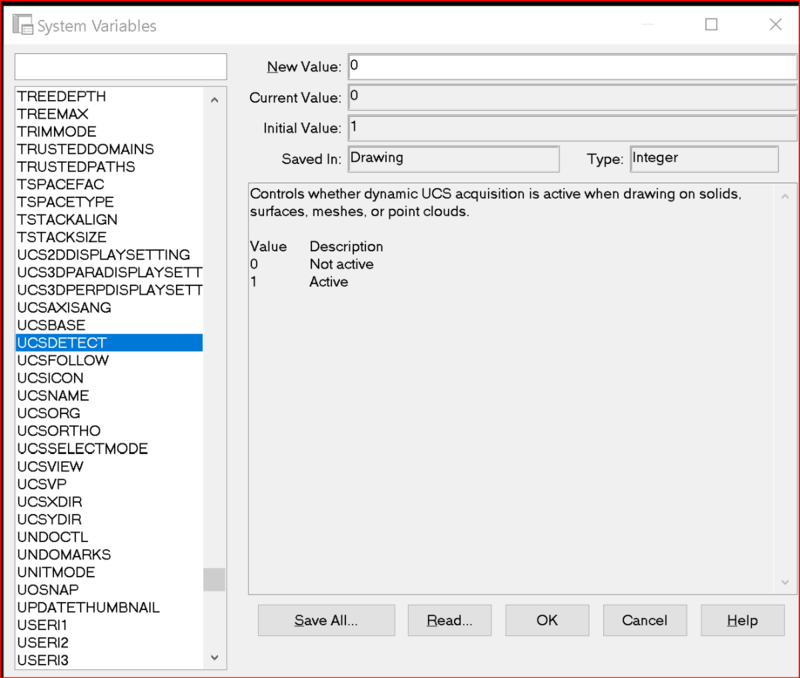

I didn't mean to suggest that you were a newbie, nice looking models. As it turns out having had an .SVF file wouldn't have gotten you out of that particular conundrum, as UCSDETECT setting is saved in the drawing, not the registry, as explained in this screenshot from the SYSVDLG (SystemVariableDialog)...wherein one can learn plenty. I favor just using my cursor arrow to scroll down through any parts of the list which seem intrigueing. Done that way, each variable and available options will be displayed until you click it again to scroll to the next System Variable. If you have such a file and are working at another machine, you can instantly tweak it to your personal preferences. Have a heart though, and if you are on someone else's machine, make sure you save their >SVF file before installing yours, so you can restore them before exiting the machine.1 point
