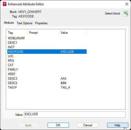

  1. @jr.roberto.santos All those blocks 'ASSYCODE' values are EXCLUDE not EXCEPT .. that's why it does not work. I updated the code above so try again .. if you change that one block's attribute to 'EXCEPT' it works..
