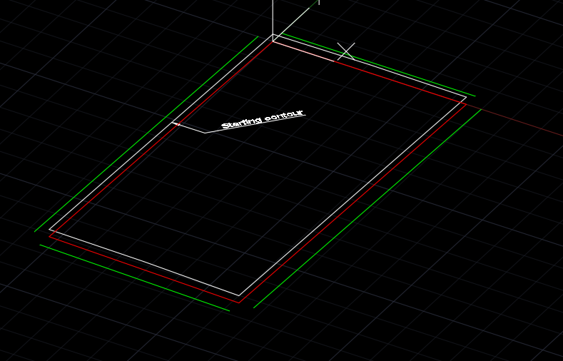

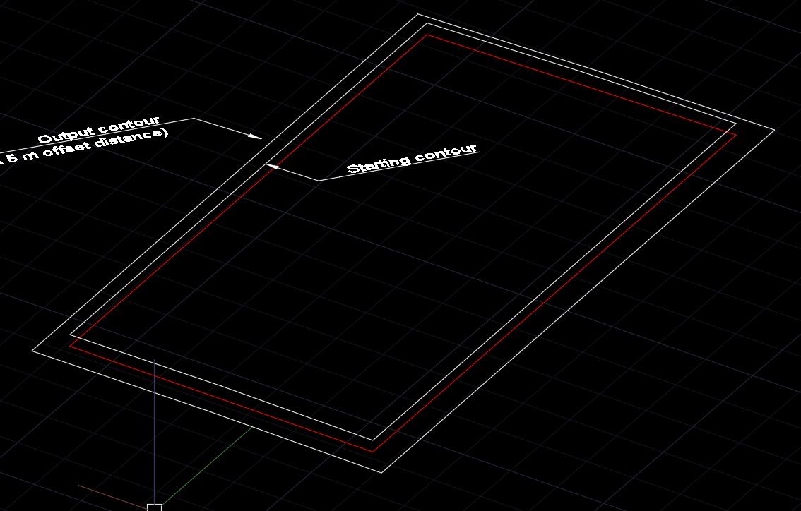

The following process is tedious but will yield the desired result (I think). Working on a new layer create 4 lines snapping to the vertices of the 3dpoly. Move the 4 lines in Z by - 2.5 ( 50% x 5m offset distance). Select one of the lines and use UCS OB to set a ucs for the line. Use Offset with a distance of 5. Repeat steps 3, 4, and 5 for the other edge lines. This will yield the lines shown in green below. Use chamfer to complete the 3D offset.2 points

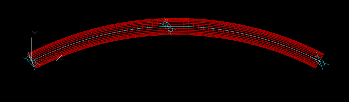

One issue not immediately apparent is that the two ends of the Revit geometry (Pipe) are cut at an angle not square to the prescribed arc. Hence, the inner and outer sections are elliptical, not circular. Using the sectional geometry near - but not at - the ends, circles could be recreated via 3PtUCS then 3PtCirc (Radii 5.40 and 5.03). An additional application of that procedure near the pipe’s midpoint gives three circles to work with. Like the above sequence, the three circle centers can be used with 3PtUCS then 3PtArc. A circle can be swept along that arc, and the two ends can be SolidEdit – Offset to extend beyond the Revit geometry, and 3Pt Slice can match the odd angles. 3DPipe_2016.dwg1 point

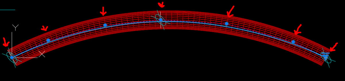

It appears that the tube lies on a plane so the first step is to create a UCS with an XY plane that passes through the center of the tube. I used three points located at the center of the tube at its ends and approximate midspan. I tried fitting an arc to the curve by finding the intersection of of the perpendicular bisectors for the lines connecting the end points to the midpoint but determined that the shape could not be approximated with an arc so decided to create a spline for the tube's centerline. I like creating splines using Control Vertices as it gives me better control. I started by creating a spline with 7 CVs making sure it started and ended at the precise end points of the tube. I wasn't too careful about the location of the other 5 CVs as I know they would be moved. It is important to keep in mind that the second CV and the next to the last CV control the tangent direction and radius of curvature of the spline at its beginning and end. Once I had the 7 CVs and with all object snaps off I moved the 2nd CV relative to the end making sure to keep the tangent vector correct but observing how the radius of curvature was changng as it met the tube's curvature. Once I was happy with the beginning and the end shape I moved on to moving CVs 3, 4 and 5. The results are not perfect but should be sufficient. It is best to use as few CVs as possible. Many people think more is better but more CVs (or fit points as well) can actually produce worse results as their is an increased likelihood of getting ripples in the curve when using too many defining point (CV or Fit).1 point
