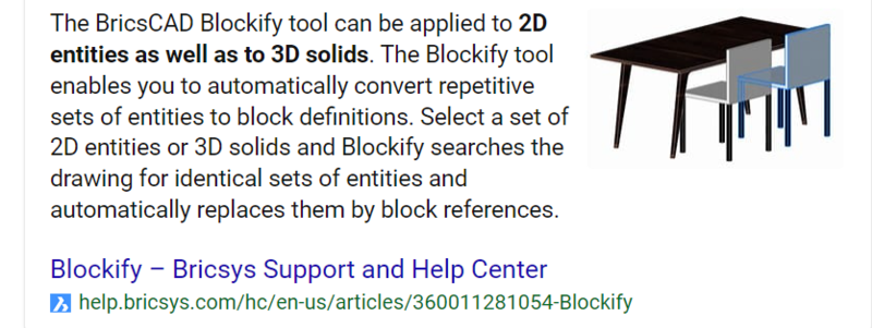

  4. Bricscad has a make block where it looks at patterns of objects, Ask company to send un exploded, they just dont want you to use there blocks.
