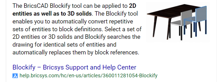

  9. Yeah the objects are to obscure because they have say different text inside circle, Blockify did not seem to work.
    1 point
  10. Bricscad has a make block where it looks at patterns of objects, Ask company to send un exploded, they just dont want you to use there blocks.
