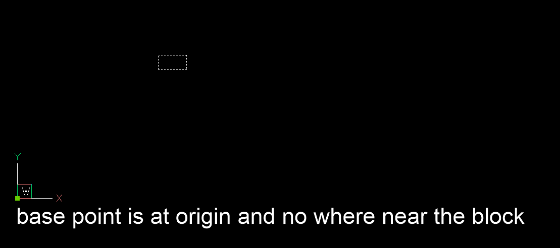

  9. ; IB - 2022.06.10 exceed ; https://www.cadtutor.net/forum/topic/75382-use-lisp-to-create-block-and-autoselect-objects-with-ssget/ ; ; make block with instant name. example is all circle (defun C:IB ( / ss oldcmd box midpt ) (setq oldcmd (getvar 'cmdecho)) (if (= oldcmd 1) (setvar 'cmdecho 0)) (if (setq ss (ssget "_X" '((0 . "CIRCLE")))) (progn (setq box (LM:ssboundingbox ss)) (setq midpt (list (/ (+ (car (car box)) (car (cadr box))) 2) (/ (+ (cadr (car box)) (cadr (cadr box))) 2))) (command "_.COPYBASE" midpt ss "") (command "_.ERASE" ss "") (command "_.PASTEBLOCK" midpt) (princ "\n IB - complete") ) (progn (princ "\n IB - there's no object for making block") ) ) (setvar 'cmdecho oldcmd) (princ) ) (vl-load-com) ;; Selection Set Bounding Box - Lee Mac ;; Returns a list of the lower-left and upper-right WCS coordinates of a ;; rectangular frame bounding all objects in a supplied selection set. ;; sel - [sel] Selection set for which to return bounding box (defun LM:ssboundingbox ( sel / idx llp ls1 ls2 obj urp ) (repeat (setq idx (sslength sel)) (setq obj (vlax-ename->vla-object (ssname sel (setq idx (1- idx))))) (if (and (vlax-method-applicable-p obj 'getboundingbox) (not (vl-catch-all-error-p (vl-catch-all-apply 'vla-getboundingbox (list obj 'llp 'urp)))) ) (setq ls1 (cons (vlax-safearray->list llp) ls1) ls2 (cons (vlax-safearray->list urp) ls2) ) ) ) (if (and ls1 ls2) (mapcar '(lambda ( a b ) (apply 'mapcar (cons a b))) '(min max) (list ls1 ls2)) ) ) add function for center point as base point how about this?
    1 point
  10. Thought of that too but you end up with blocks like this.
    1 point
  11. ; IB - 2022.06.10 exceed ; https://www.cadtutor.net/forum/topic/75382-use-lisp-to-create-block-and-autoselect-objects-with-ssget/ ; ; make block with instant name. example is all circle (defun C:IB ( / ss oldcmd ) (setq oldcmd (getvar 'cmdecho)) (if (= oldcmd 1) (setvar 'cmdecho 0)) (if (setq ss (ssget "_X" '((0 . "CIRCLE")))) (progn (command "_.COPYBASE" "0,0" ss "") (command "_.ERASE" ss "") (command "_.PASTEBLOCK" "0,0") (princ "\n IB - complete") ) (progn (princ "\n IB - there's no object for making block") ) ) (setvar 'cmdecho oldcmd) (princ) ) how about this? this is the method using that ctrl+shift+v. It might be easier to leave it to the "command" than to generate a serial number for the name.

  12. @mhupp That Set_BlkName code seems a bit overkill when you could do something as simple as this (defun _blockname (prefix / i r) (setq i 0) (while (tblobjname "BLOCK" (setq r (strcat prefix "_" (itoa (setq i (1+ i))))))) r ) (_blockname (getenv "USERNAME")) Or if you want to tie the date to the name: (defun _blockname (prefix / r) (while (tblobjname "BLOCK" (setq r (strcat prefix "_" (menucmd "M=$(edtime, $(getvar,date),YYYY-MO-DD.MM)"))) ) ) r ) (_blockname (getenv "USERNAME"))

  14. While manually selecting items to be in a block is sometimes slow. I would advice against using ssget "_X" when making block selections. it takes most of the control away from you. Yes you can filter it down but do you want all circles in the drawing to be in this one block? This is a stripped down version of my quick block lisp. run command and promoted to name block. if you either try to name it an already existing block name or leave the name blank it will auto generate a random name like "$J34K4-2V0489". Same with the base point you can either pick it or just right click and it will be in the middle of selected entity's. ;;----------------------------------------------------------------------------;; ;; Quick Block - Creates Block from selected objects (defun C:QB (/ SS blkname mpt ptslst minpt maxpt LL UR) (if (setq SS (ssget)) (progn (if (or (eq (setq blkname (getstring T "\nBlock Name: ")) "") (/= (tblsearch "block" blkname) nil)) (Set_blkname) ) (if (not (setq MPT (getpoint "\nSpecify Base Point: "))) (progn (foreach ent (vl-remove-if 'listp (mapcar 'cadr (ssnamex ss))) (vla-getboundingbox (vlax-ename->vla-object ent) 'minpt 'maxpt) (setq ptslst (cons (vlax-safearray->list minpt) ptslst) ptslst (cons (vlax-safearray->list maxpt) ptslst) ) ) (setq LL (apply 'mapcar (cons 'min ptslst)) UR (apply 'mapcar (cons 'max ptslst)) MPT (mapcar '/ (mapcar '+ LL UR) '(2 2 2)) ) ) ) (vl-cmdf "_.Block" blkname "_non" MPT SS "") (vl-cmdf "_.Insert" blkname "_non" MPT 1 1 0) (prompt (strcat "\nBlock [" blkname "] Was Created.")) ) (prompt "\nNothing Selected") ) (princ) ) ;;;======================================================================== ;;; ;;; *** AUTO-BLOCK.LSP *** ;;; BLOCK CREATION ON THE FLY : "Just select your objects" ;;; ;;; By Raymond RIZKALLAH, October/2004 ;;;======================================================================== (defun Set_BlkName () (setq o-dmzn (getvar "dimzin")) (setvar "dimzin" 0) (setq c-date (getvar "cdate")) (setq w-all (rtos c-date 2 20)) ;; >> "20041022.11423489" (setq w-yr (substr w-all 3 2)) ;; ["01" to "99"] >> "04" (setq w-mn (substr w-all 5 2) ;; ["A" to "L"] >> "J" w-mn (chr (+ 64 (read w-mn))) ;; ) (setq w-dy (substr w-all 7 2)) ;; ["A" to "Z" + "1" to "5"] >> "V" (if (<= (read w-dy) 26) ;; (setq w-dy (chr (+ 64 (read w-dy)))) ;; (setq w-dy (rtos (- (read w-dy) 26) 2 0)) ;; ) (setq w-hr (substr w-all 10 2) ;; ["A" to "S"] >> "K" w-hr (chr (+ 64 (read w-hr))) ;; ) (setq w-mt (strcat (substr w-all 12 1) "-" (substr w-all 13 1))) ;; ["00" to "59"] >> "4-2" (setq w-sc (substr w-all 14 2)) ;; ["00" to "59"] >> "34" (setq w-mm (substr w-all 16 2)) ;; ["00" to "59"] >> "89" (setq blkname (strcat "$" w-mn w-sc w-hr w-mt w-dy w-yr w-mm)) ;; >> "$J34K4-2V0489" (setvar "dimzin" o-dmzn) (princ) )
