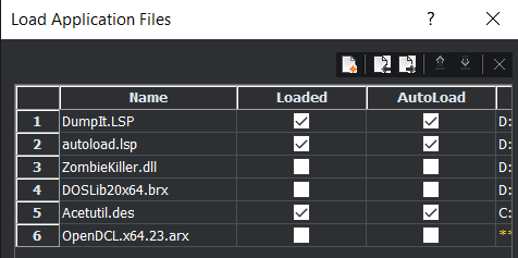

Likewise I have a similar LISP on startup, the variables I like to use (might be stealing some of that list) and loading the LISPs I most often use. Taking BigAls LISP a bit further, I have one "Appreload" which loads all the LISP files in my library, which could also be run at start up, can be modified to princ each lisp file name as it loads (defun c:appreload ( / lspname myfiles acount mylistlength Failedtoload) ;;Re-load named LISP files (setq mylispfolder "C:\\Users\\wherever\\") ;;;;;; change this line ;;;;;;;;; ;;;;;;; edit for laptop ;;;;;;; Laptop maps company driver differently to desktop so added this (if (= (findfile "C:\\Users\\wherever\\SIMPLELISP.lsp") nil) ;;;; if it can find this file do nothing.. use anyfile in your library (setq mylispfolder "C:\\Users\\lapTop File Location\\") ) (setq myfiles (vl-directory-files mylispfolder "*.lsp" nil)) ;;myfiles is list of files in mylispfolder location (setq mylistlength (length myfiles)) ;;count of number of lsp files (setq acount -1) (repeat mylistlength (setq acount (1+ acount)) (setq FailedtoLoad (strcat (nth acount myfiles) " failed to load")) (load (strcat mylispfolder (nth acount myfiles)) FailedtoLoad) ;;Loads each LISP file ) (princ "\n") (princ mylistlength) (princ " lsp files loaded from ") (princ mylispfolder) (princ) ) and one for mhupp, snaps (AutoCAD, not sure if Bricscad does it the same way? ;;Snaps. ( * 1.. to use snap, ( * 0 to turn off snap. (setq snaps 0) (setq snaps (+ snaps (* 1 0))) ;None (setq snaps (+ snaps (* 1 1))) ;End Point (setq snaps (+ snaps (* 1 2))) ;Mid Point (setq snaps (+ snaps (* 1 4))) ;Centre (setq snaps (+ snaps (* 0 8))) ;Node (setq snaps (+ snaps (* 0 16))) ;Quadrant (setq snaps (+ snaps (* 1 32))) ;Intersection (setq snaps (+ snaps (* 0 64))) ;Insertion (setq snaps (+ snaps (* 0 128))) ;Perpendicular (setq snaps (+ snaps (* 1 256))) ;Tangent (setq snaps (+ snaps (* 0 512))) ;Nearest (setq snaps (+ snaps (* 0 1024))) ;Geometric Centre (setq snaps (+ snaps (* 1 2048))) ;Apparent Intersection (setq snaps (+ snaps (* 0 4096))) ;Extrnsion (setq snaps (+ snaps (* 0 8192))) ;Parallel (setq snaps (+ snaps (* 0 16348))) ;Superess all running snaps (setvar 'osmode snaps)2 points

As you say if blocks are a mix then a problem. The solution appears to be 2 steps not one. You should be able to stop in your script, been a while, generally its no user input, any way a script can have lisp code in it or call a lisp program that program may have a stop and ask a question. Only a quick look but add set units.lsp to your Appload Start up suite then the functions will be available. remove the (command ".script" (strcat folderName "\\batchJob.scr")) in batchjob code. Your batchjob1.scr should be, (BatchJob) (command ".script" (strcat folderName "\\batchJob.scr")) The script needs (c:UNITSET) to be added after open dwg1 etc in batchjob I think that is what you need. Not tested. open dwg1 (c:UNITSET) close Y open dwg2 (c:UNITSET) close Y You dont need lee's bounding box can just load the boundingbox lisp as part of the script.1 point
