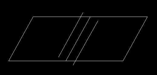

So you want to draw 3 lines from 2 pick pts ? What happens with this. A more specific global style routine may be a better solution, the line intersect points can be found and the lines adjusted. It would still use offset. If you always have a HOR VERT rectang then why not rework out the 4 pts you know offset. You can detect the line/pline at the pick point and get its angle. Its nearly always better to post a diagram of what you want in 1st post.1 point
