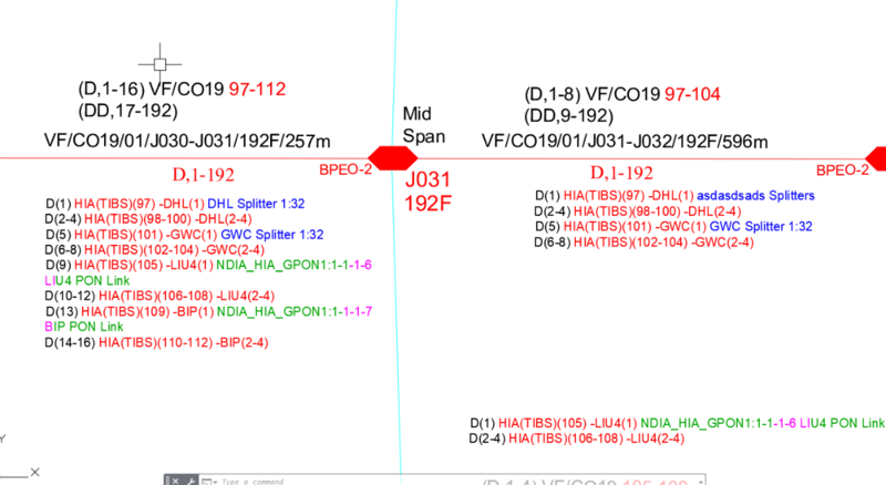

  4. Just an update , the test replace did work ,but not on all the mtext ,I just used the textreplacefunc in you LISP. My in input was OLD text:DHL Splitter 1:32 New Text:asdasdsads Splitters Ideally it should have changed all the texts

  5. Since the string to be found is already being passed an argument to your function, you can 'hardcode' it by simply defining another function which evaluates your function with a hardcoded string, e.g.: (defun c:test ( ) (chkmtxtstr "MyTextString") ) Though, if you're happy with a case-sensitive match and assuming the MText content has no formatting and does not straddle multiple DXF group 3 entries, the code can become much simpler - consider the following: (defun find ( str ) (ssget "_X" (list '(0 . "MTEXT") (cons 1 (strcat "*" str "*")))) ) Since the above will return a selection set, you can call it in the following way: (defun c:test ( / sel ) (if (setq sel (find "YourString")) (command "_.change" sel "" "_p" "_la" "0" "_c" "ByLayer" "") ) (princ) )
