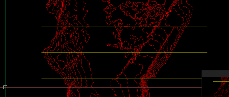

  2. They are contour lines correct ? So do you want say contour labels done by dragging a line across would make more sense the same way CIV3D does it. This will give a neat pattern, if you do at 150 spacing the labels will be all over the place. If you use (ssget "F" (list pt1 pt2)) you can get a selection of the crossing 3dpolys using getcoordinates you can look a the 3rd item in the list that is the Z value. Ok so before say I or others do something is that ok draw lines for contour points.
