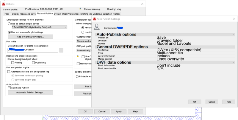

  3. I am not a member of The Lisperatti, so this may not be of interest to you. Are you familiar with the Automatic Publish functionality of Autocad? As shown in the screenshot. I don't USE it, but I know that it will automagically create a new folder for your PDFs, once setup. As I recall in the same folder as your original dwgs., but configurable.
    1 point
