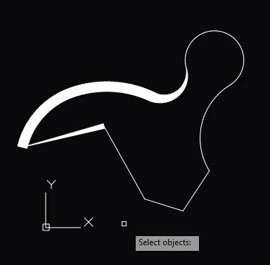

  3. Give this a try: (defun c:foo (/ a b el h pts s) ;; RJP » 2022-08-31 ;; Explode LWPOLYLINES and keep segment widths (if (setq s (ssget ":L" '((0 . "LWPOLYLINE")))) (foreach e (vl-remove-if 'listp (mapcar 'cadr (ssnamex s))) (setq h (assoc 10 (setq el (entget e '("*"))))) (setq h (vl-remove (assoc 70 el) (reverse (cdr (member h (reverse el)))))) (setq pts (vl-remove-if-not '(lambda (x) (member (car x) '(10 40 41 42 91))) el)) (if (vlax-curve-isclosed e) (setq pts (append pts (mapcar '(lambda (r j) r) pts '(0 0 0 0 0)))) ) (while (> (length pts) 5) (entmakex (append h (mapcar '(lambda (r j) r) pts '(0 0 0 0 0 0 0 0 0 0)) (list (assoc 210 el))) ) (setq pts (cdddr pts)) (setq pts (cddr pts)) ) (entdel e) ) ) (princ) )

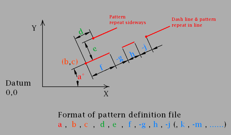

  9. I am glad it helped you. Here is a diagram of how the data for the pattern definition file is derived.
