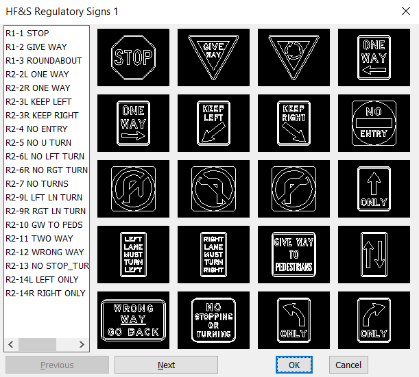

  6. Tombu you would like this, 100's of signs at your fingertips and its a TTF. So can use in say Word and Excel also. Now the bad news I can not find the company that made them "AUS Fonts" if you find them let me know.
