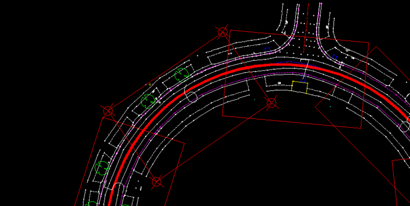

  8. Maybe a simpler way you get the 4 points of the viewport then use a trans to convert the 4 points to mspace points you can then use a ssget "WP" pts. Remember to add the 1st point as last point so box closes. ie 5 points. You want the opposite of this, this takes a point in mspace with a twist viewport etc and converts it to a Pspace point. (setq psnewcen (trans (trans newcen 1 2) 2 3)) Sorry dont have the right way at my finger tips. Trying to remember if chspace works for pspace point converted to mspace I think it does. Tried this picked 4 corners of viewport and made a POINT. You can see the points in model, the red rectangles are the viewport windows seperate code.
