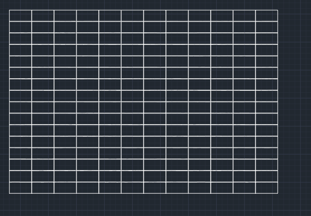

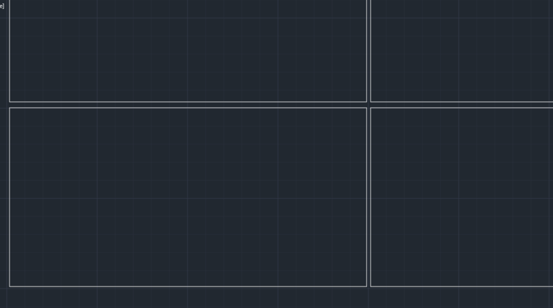

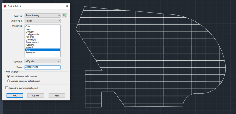

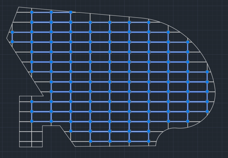

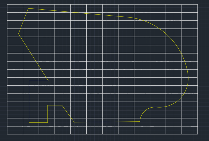

Me again with some more details. here is the array, "big enough" for the outline. What I forgot to say: make the rectangles just a litle bit smaller as you need them, so in the array they doesen't touch each-other Here is my outline, converted to region too That's what I get after using the INTERSECT command, followed by EXPLODE This is what quickselect returned and finaly the final result. Maybe I should have saved a copy of the outline before I converted it to region...1 point
